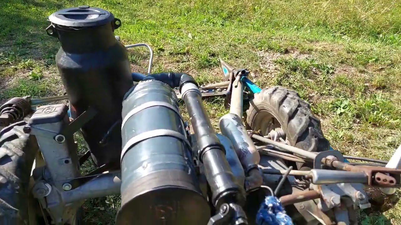

One more detail about sizing, @KristijanL . What is the diameter of gas output pipe between gasifier and the filter?
Kamil, l thenk about 45mm? All the rest is 50mm sewage pipe. Fits perfectry on the carbourator, otherwise l wuld take a smaller pipe.

(Thats a stone in behind the choke plate)

Yea, this alredy cost me a car once… probably. My woodgased Mercedes somehow got half a gallon of water in the tank. It hadnt had a l9ckable tank lid… but l cant be sure.
But moral of the story here, no matter how much your wife pisses you off at times, always love her. She is the one that found the stone playing with the choke flap while l worked on the new filter housing.

Hi Kristijan
do you manage to get dry gas with this gasifier?
is all the water cracked with this gasifier?
Thierry
Yes, a bit too dry actualy. I need to use a different filter media, it seems the towel fibres pack with dry ash and get restrictive over time. Idealy, the gas shuld be just a tiny bit damp so that the ash forms a nice cake on the filter.
Also, l noticed l get some ash past the filter. I think the reason is since the machine vibrates strongly and the 1 cilinder engine pulsates so much, is shakes the filter media too much. I need a biger but tighter media.

have you tried increasing the amount of water in the charcoal? The gas should become wetter!
hi kristijan, great build, one more woodgas mower in europe!!..your kids, with the water in the mercedes tank…shurely they once became also great inventors like you, they try just to drive with water…hydrogen…
why you have choosen 5 nozzles instead of the usually one at charcoal systems?
for bridging reasons?
for complete water splitting reasons?
or less(?) nozzle consumption…?
