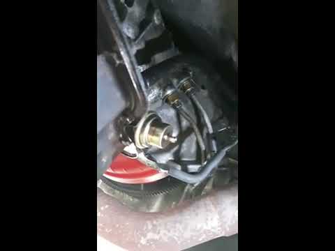

Since im going to get the chevy truck up and running, i remembered a small problem i’ve ignored some time now, on the truck i have a th400 auto-trans, and when driving on wood, the shifts are somewhat “delayed” and rough, i’ve rebuilt the trans maybe 3 years ago, the problem became much more noticeable.
I think this should have to do with the vacuum modulator (new), the trans otherways works as a dream when driving on gasoline.
Is it anybody noticed the same?
I know there are adjustable vacuum modulators, maybe possible to find a sweet spot inbetween?
I would definitely see if your current modulator is already adjustable. Or get an adjustable one. When you look into the hose barb on the modulator the valve will have a flat headed screwdriver slot cut for adjusting. Rotating tighter will firm up shift points and loosening will soften shifting. I don’t think it actually changes the MPH shift points per se but it does change the firmness, how much vacuum is required to go the next gear. If you’re heavy on the throttle a lot then manifold vacuum will be high so you’d want to firm up shifting. If you’re easy on the throttle then maybe loosen it some.
Do you drive lightly on gasoline and then heavy with throttle on woodgas? Maybe this explains the rough shifting.
Thank you Cody, that was the answer i was looking for, as for driving im gentle on the throttle on gasoline, and even more on woodgas just to avoid the hard shifting, that almost shakes the truck. Anyways there is a distinct difference between gasoline and woodgas driving.
I should definitely look if the vacuum modulator is adjustable, had not thought about looking into the vacuum connection.
