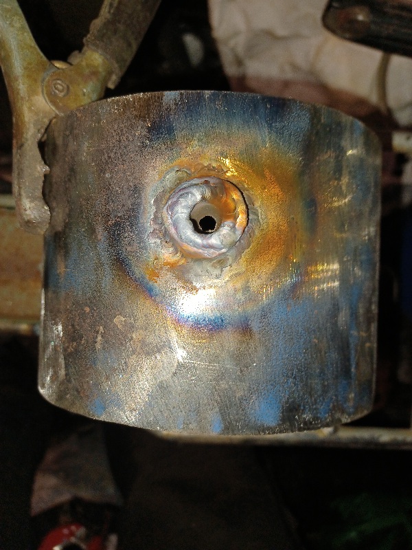

I slip in a little update on the moped gasifier, im slowly recovering from covid, so today i felt good enough to do a little cutting and welding.

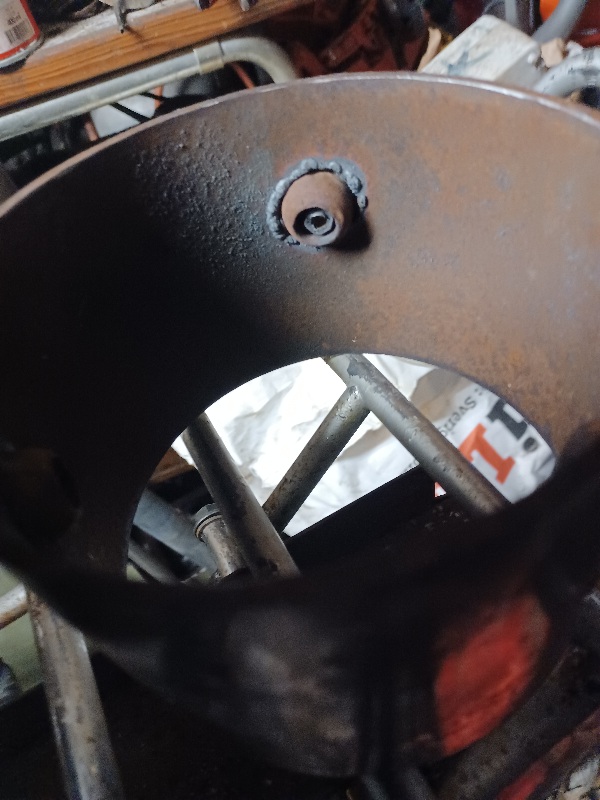

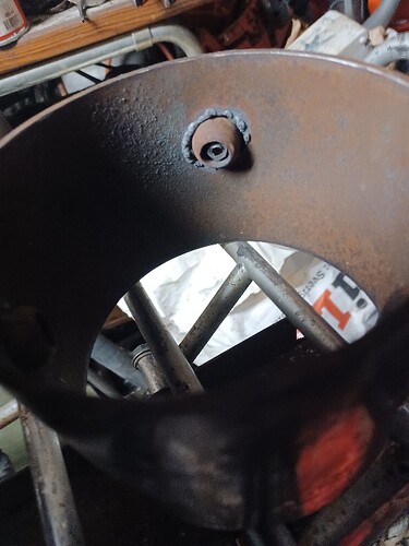

Im going to try this, a piece cut off from an old gas-bottle, i’ve welded 3 of the nozzles in to it, then i made some “reducers” out of stainless hydraulic tubing, and welded them inside.
Hopefully the kanthal nozzles should shield the pipes so they hold up better?
Im going to cut the fire extinguisher, that should become the gasifier, and weld in this piece, then make a air-mantle, mostly to get even air-distribution, to shield from air draft, and to adapt water-drip or steam.
