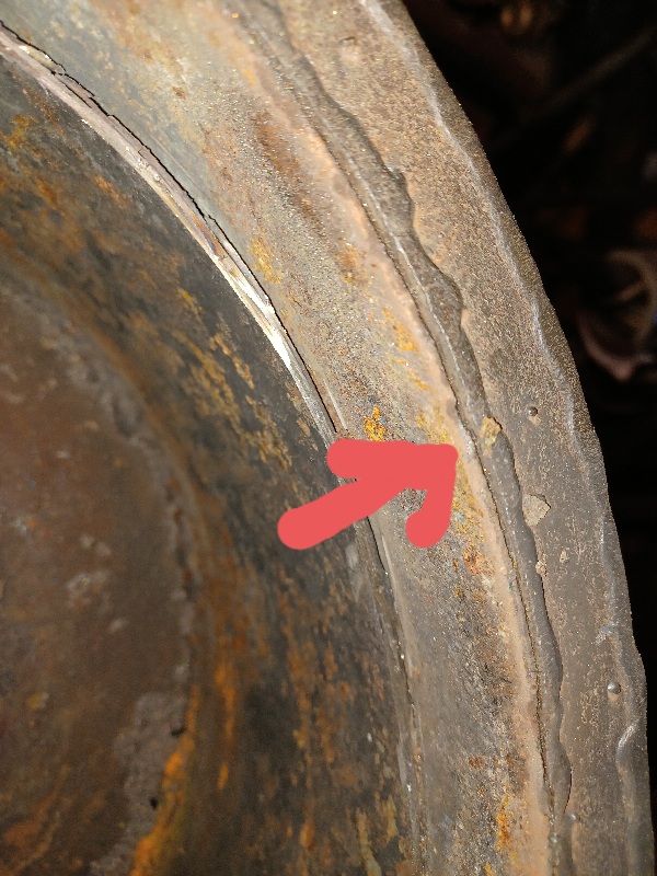

Anyhow, i did some further inspection on the hearth of the chevy gasifier, found this crack in the bottom of the air chamber.
It doesn’t look like heat-distortion/warping, my theory is i had somehow water standing in here that has frozen and expanded, i base that theory on that the truck was standing some 3-4 month’s during wintertime due to a broken rear axle, as i think about it, it has never run perfectly after that, often get very weak gas when over-pull/over-heat the gasifier which could be this crack open-up by heat expansion?
Just theories but seems possible.
Now for this “fun” part, stainless should be extremely clean from organic/carbon when welding to not “infect” the weld, yeah, good luck with that in a gasifier, i can take a little rust :grinning:

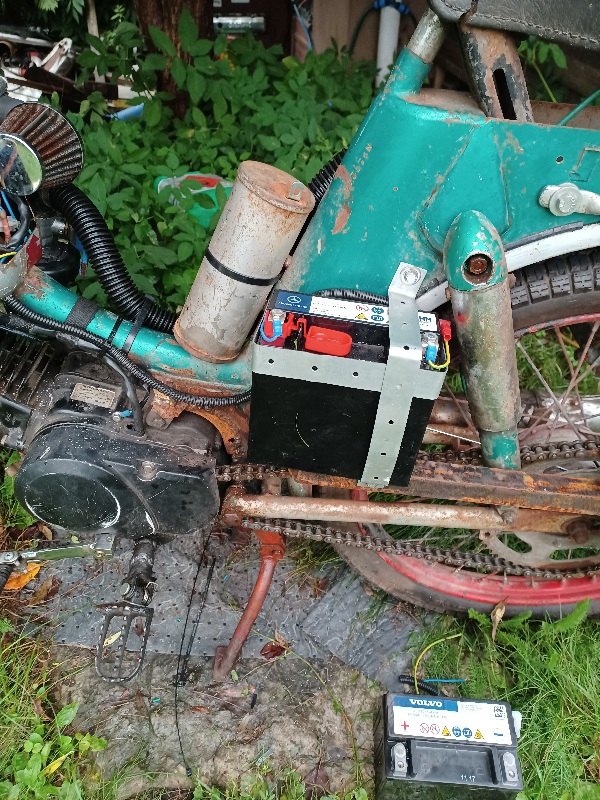

I’ve mounted a battery for the blower on the moped, very “discreet” installation, really blend’s in :roll_eyes:
I planned to mount a smaller, motorcycle battery, but this was free, so… It’s the type lead battery that is mounted in many cars with start-stop function, as a electronics “memory” battery, these are changed out parallell with the standard battery, and these are often good enough.

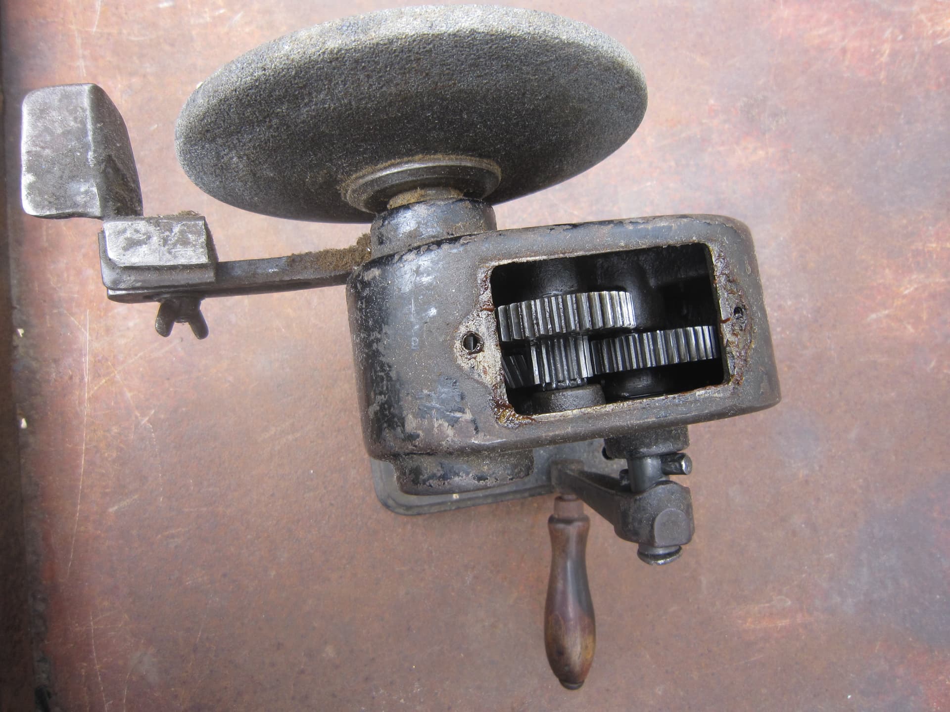

i found on internet market place this grinder…the gear makes 24 : 1 …i will use for my next gasifier as hand blower gear…the model with 4 axles is the speediest, others have 3 axles, and are slower, but with a additional bicycle sprocket gear at the crank should also give high turns…
That is a very good idea Giorgio, i have saved a gearbox from a very old flexible shaft clipping machine (Chicago clipper, for horses and cow’s) i belive that should be a good gearbox for the same purpose.
Some of the war-time hand crank starter blowers had a gearing around 1:200, very heavy to get going but when up to speed you only have to “follow” the crank, much like the old cream separators.
