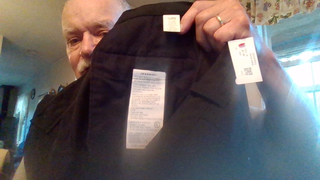

Nomex fabric can sometimes be found in used clothing.
I got these 2 Firefighters Nomex station-ware pants at a thrift store on old-man discount day for $4.00 each.
LION duty ware brand.
Lots of filtering material in my big-assed size.
That is a really good deal, SteveU, i only wish i could find some here in Sweden that way, but firefighters stand under municipal/government control, wich means: supplier of fire resistant clothes make them promise to NOT sell or give away anything in Sweden, give to other countries are okay, this is only to avoid their own used stuff to compete what they sell new (like it’s a big market for firefighter uniforms :roll_eyes:) they often have some bad excuses, like the clothes are’nt safe when they are used just one time.
This is only, what i believe sellers/buyers scratching each others back’s, handle money under the table.
(Alot of this is confirmed, when i asked local firefighters) anyway i got tip of a upholstery shop that repaired clothes for the firefighters, that way i got a lot of fireproof sewing thread.
Enough rambling about that, another way i checked is those racing overalls, mandatory in every motor-sport here, but even the second-hand value of these nomex-overalls is to high.
