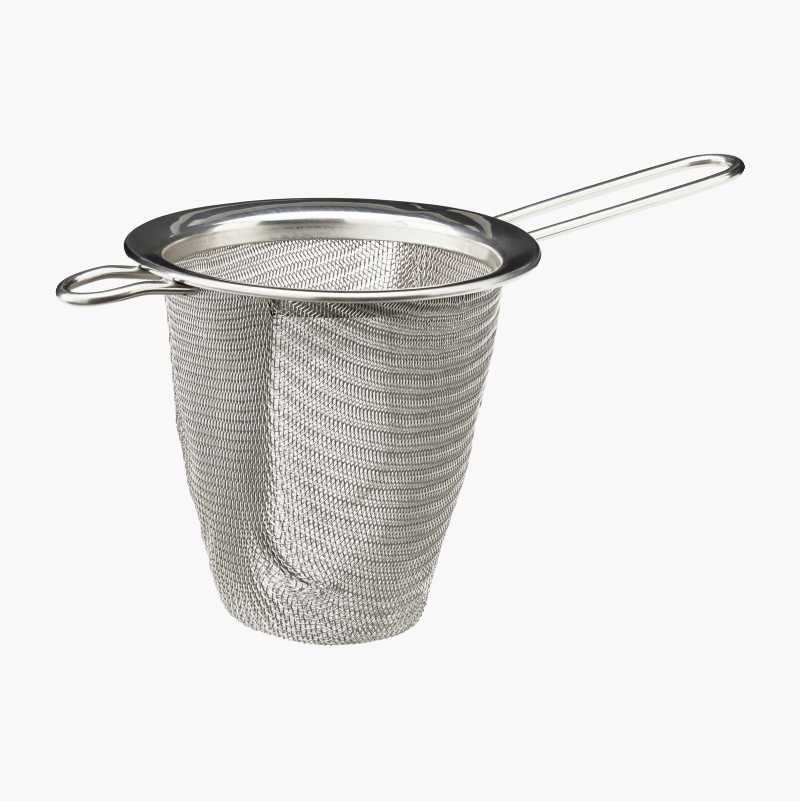

I know that Niklas uses this as a security filter.
Where does he locate it, inline to the carburetor? I have thought about installing a mesh filter in the air cleaner or just in line before it to reduce nasty stuff accumulating.
Safety filter for dust isnt much of a problem. But for tar, lsuggest thin felt. It lets gas trugh fine, but even small amounts of tar will plugg it up, leting you know aomething is wrong. This probably savedme a few headakes
Niklas has a safety filter right before the intake, he has a screw coupling (dairy coupling) which is easy to take apart and put back.

Jan, that was smart, Niklas using a tea-strainer as safety filter, almost exactly like the safety filters used during ww2.
