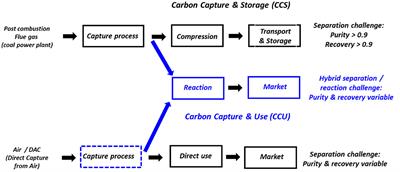

In this case he is making honey mead as his source of CO2 but anything that ferments would work. You can also use a few other things to get a purer CO2 stream including membranes. But it is really carbon capture and storage.
There has been a lot of work for ‘cheap’ ways to extract CO2 from the air. At .04%, it is pretty spaced out. You have to cool to -79C to get solid CO2.
