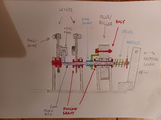

Hi all, as i promised to try to explain my woodgas/gasoline shifting device, i made a little sketch, hope it’s somewhat understandable ![]()
The sideways shifting axle is a standard 6mm allen-key (i hope it’s the right name for it) the little longer type, for the hollow shafts i used some kind of fully threaded brass pipe, i think it’s for some kind of electrical installations.

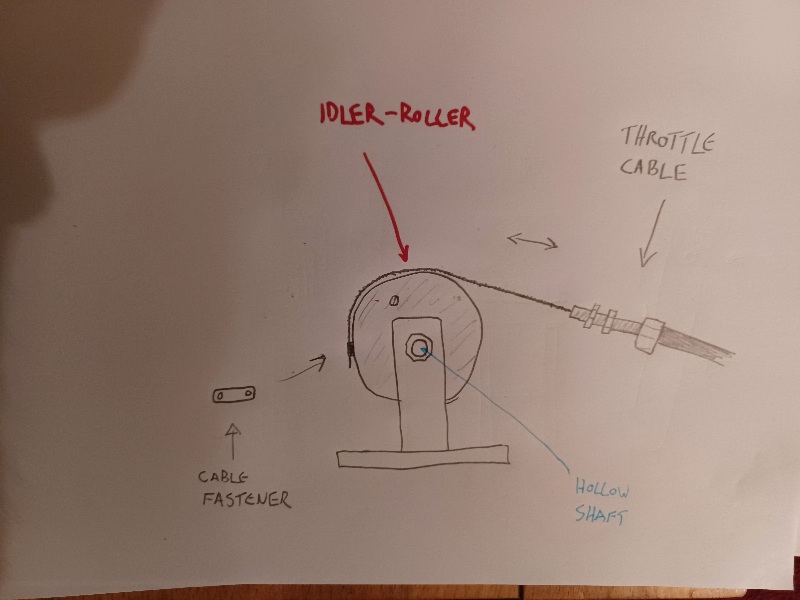

The “wheel” throttle cable runs around is a used idler roller from a belt transmission, the cable is fastened with a little strip of sheet metal.
Please notice this drawing is not all correct, just to show the principle.
There is a piece of sheet metal bolted onto the roller, with a piece of a 6mm socket to couple with the allen key.
The lever in the right works cross-wise to the other two, it is controlled by a cable attached to the lever at the woodgas shut-off valve, when it is pulled it pushes the key over to control the other lever, otherwise the spring pulls it over.
Side-view.
Please feel free to ask, or correct me if i translated something wrong.

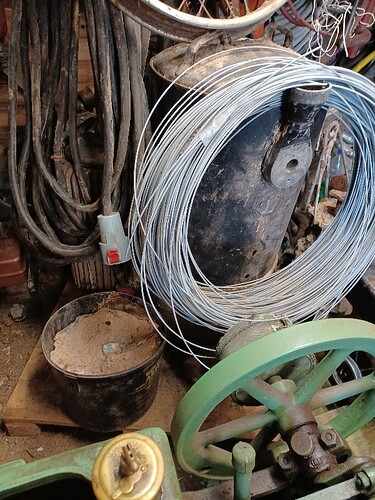

I forgot i had this one: a Lion charcoal gasifier it’s hiding under the roll of wire, cooler/filter is visible behind the bucket, under the extension cord, thought i could post it here.
Lion gasifiers was made by: Gustavsson & Gortz in town Örebro, not long from where i live, same town where mr Svedlund run his company AB-GASGENERATOR.
Sorry for the history lesson, i just love the old woodgas related stuff, and like to share it.
There’s still lots to learn from the old systems, just by looking at where they had wear and tear from heat cycling etc.

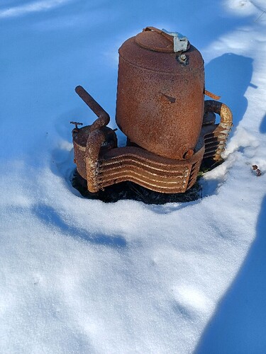

Visited a friend today, took the opportunity to take a pic of his old charcoal gasifier.
This is a: Rolls K13, charcoal unit, think it’s a nice “design” to put in the front of a car.
Fun history with this one, it once belonged to the former political secretary of Olof Palme, Swedish prime minister, murdered 1986.
Forgot to mention, this gasifiers as new was painted black and silver, with “speed stripes” in silver.
