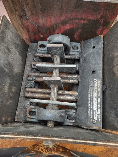

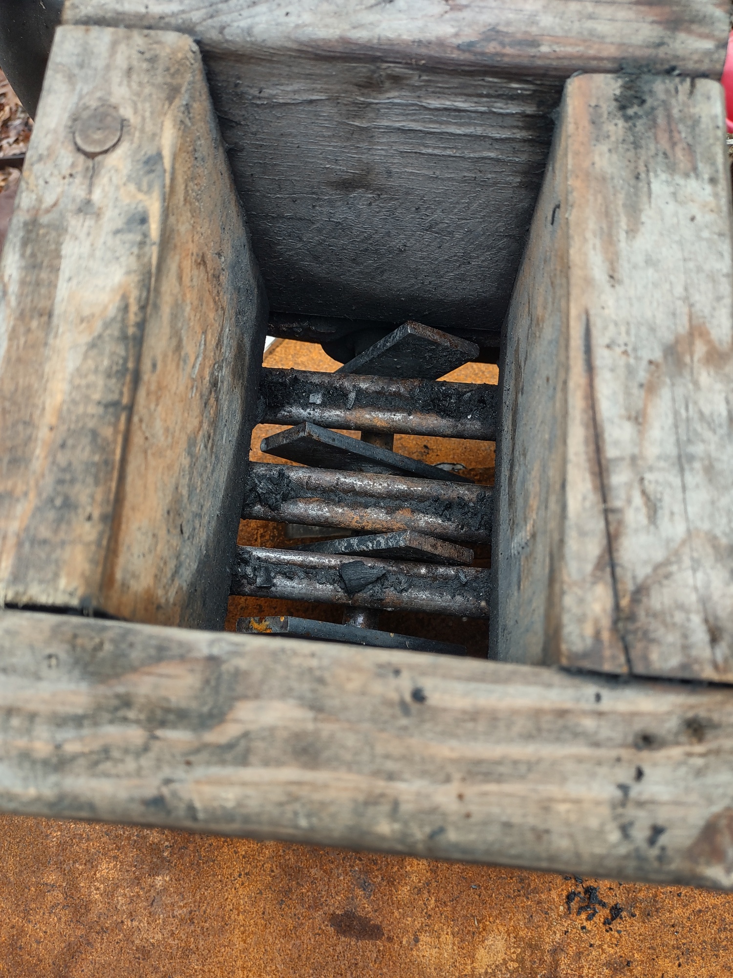

One way you could make it adjustable is have wide space between the teeth of the roller, and for engine grade you’d have a smaller gap, for forge walnut size you would use a narrow bar. Here’s how I made mine. I think the sizes it puts out is great for either downdraft or updraft charcoal. First picture it is upside down to show the guts and second picture is how I have it situated when grinding.
It would be simple enough Goran. Make the spaces for the bigger chunks and then drill and tap the ends of the square teeth so that you could screw extensions on them for the smaller fuel sizes. Since you are into forging I need to look up the the Chuck Whitlock video of the forges he makes. I think fuel size charcoal would work just fine in one. I couldn’t locate it on the site. I’ll have to go to Youtube later.
Chuck Whitlock’s charcoal production method also typically makes decent forge sized chunks. The wood burning over time and falling down while filling the barrel makes a good pre sized chunk.
It’s one reason why I use that method more than the other experimentations.
Flame cap is dummy simple and the only downside is you have to be around it the entire time to feed it unlike a batch method of Matt’s design or a TLUD or retort. Matt’s design is kinda a hybrid of batch and attention required design since you can just keep feeding it until you run out of catch cans.
OK. I admit I suck at computers. Still trying to find the videos of Chucks Daughter working the forge. So far all I can find is his business site.
Thanks for the input guy’s, please keep it coming,
As for now im leaning against make a roller, divided in three sections, just to be able to crush different sizes, without adjusting anything, just dump it in next section.
Just hit me, i think i just make two sections, coarse and fine.

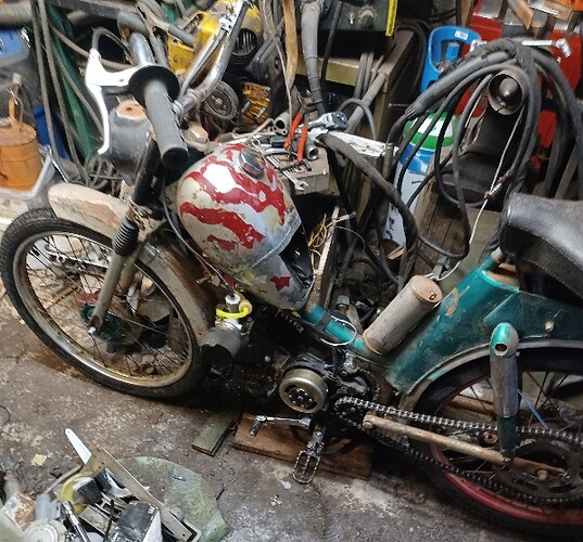

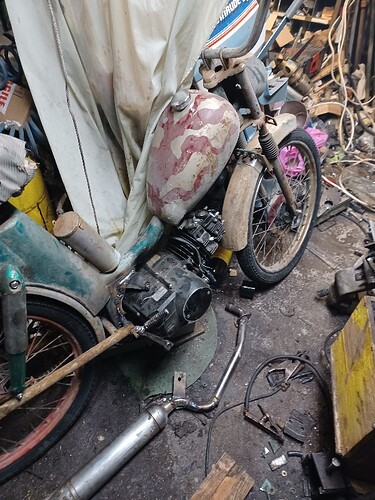

Instead i’ve started a little side-project, inside my little shop, the scrappy moped i posted in the “looke
what followed me home” thread has got a engine mounted, cheap chinese clone, the rim’s got some better spokes, new tires, chain is lined up, exhaust welded together, and brakes are checked.
Now it’s a little wiring, and carb mount, then it should be ready for a test drive (on gasoline) before i convert i to charcoal gas. ![]()
This is somewhat a “just for fun” project, but it’s also serious, it should be usable.

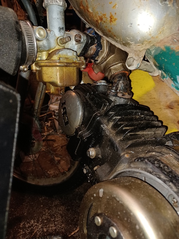

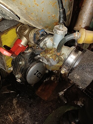

Made some progress on the moped today, mounted foot-pegs (is that the right word?) a smaller saddle (to make space for gasifier) and rebuilt the intake, mounted a three-way ball-valve, and adapted the carb to the left side, on other side mixer goes.
Some bad pic’s i know, but it’s hard to take pic’s with fingers covered with sealing compound, without messing up the camera/phone

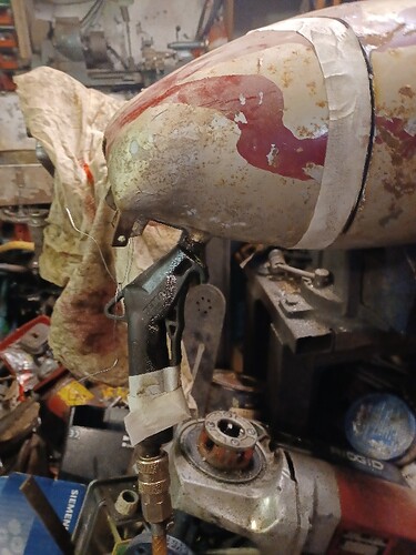

Had some spare- time for the moped project, i decided to “divide” the gas tank, by two reasons, the lower part had some rust-pinholes, so i make it a place for ignition module, and a small battery for start-up fan. Upper part used as a gasoline “reserve”.
Always scares me to cut open fuel tanks, but with a flow of compressed air no combustible mix could take place. Has used this when welding big fuel tanks, often with a vacuum- cleaner in one end, and a air-blowing-nozzle the other.

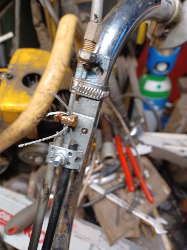

Now the fun part starts, convert it to chargas, i’ve done a “splice” at throttle cable from throttle-handle.
