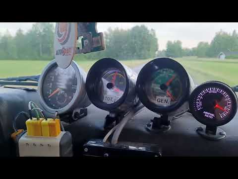

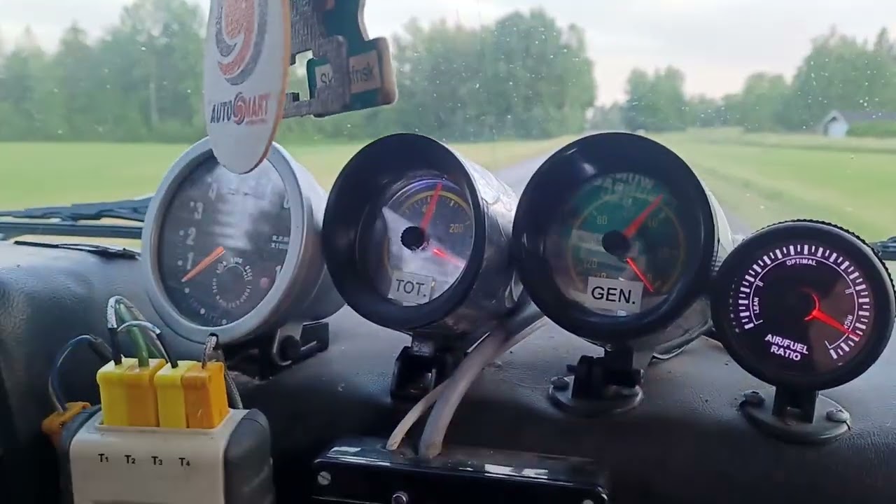

Little dirty start-up smoke, it has only run 4 miles since total emptying.
Total disaster! The supermarket had run out of lemons :grimacing:
Well that solved itself, the truck ran worse on the way home, not really bad, probably due to i drove it to hard on the way to the city, not letting the charbed establish,(i should have known better) almost home it ran as it should again, and temp readings looked more and more normal. Interesting with hopper temp readings, i haven’t used that before, so fun to know more what happens behind my back.

You say you didn’t used to have a hopper temp probe, how did you know when to refuel beforehand?
Hi Cody, on the chevy i have this enormous hopper, possible to drive 150 km without problem, so theres enough time to stop and refuel, just to keep an eye on how long i’ve been driving.
On my old Volvo with small hopper i’ve used to count 45 mins to 1 hour driving before refueling, if fuel run out to fast i felt it as a strong increase in power, which meant i had to let go of the throttle and drive gently (limp) to nearest place i could refuel, or just shift to gasoline and drive on. It was just a matter of feeling, thats whats going to be interestin with hopper temp gauge, read “fluctuations” due to bridging, wood drying, fuel level decreasing.
