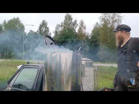

I made a little start-up video, ofcourse i burned down the wood a little to much at last run, so start-up took longer then normal :roll_eyes:
But thats the real woodgas- life :smiley: ,usually when that happens, i use to start driving on gasoline, with blower running, then shift to woodgas after some km’s.
Goran, excellent presentation of the system, even for me it takes 5-10 minutes, but when I open the hatch on my new chimney, the system heats up faster because the steam does not cool the process. If you get a chance, make a video about the shutdown, I would appreciate it. Do you vent the gases coming out of the hot gasifier through that tube where you have the ignition electrodes? You are using a pressure blower that supplies air to the nozzles, right? :+1::grinning:
Thanks Tone, a shut-down video it’s gonna be :smiley:
I let the gasses vent out through air intake, i used the chimney before, manually, but for now i just shut the engine off, the after-gassing smokes out the air-intake, which is placed beside the chimney.
Yes, pressure blower, inline with air-intake.
Thank you, Göran! Great video! Impressive set of automation.
Thanks JO, yeah i like this automation, if i let it cool of, and poke it, and refill in the evening before, im able to start up the gasifier from the kitchen, while taking a morning cup of coffee :smiley:
But the VERY best thing is: if i park it, for example on a supermarket parking lot, curious people use to check out the truck, if they get too close, touching and like, i can activate the valve and blower from a distance, this is really fun, they look all around, almost running from the truck, in the believe the did something… :rofl:
One time a older guy got almost dragged away by his wife, -You touched something!! No! I was just looking… it started automatically?!!
:grin: :rofl:
