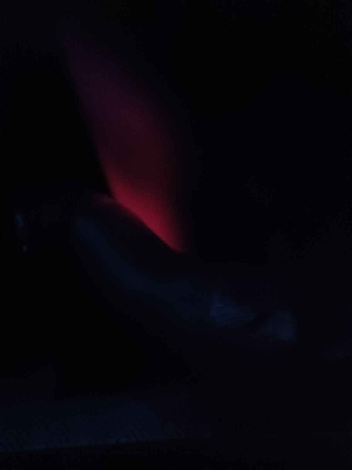

As i suspected a while ago, i got a hot leak, a crack that “opens up” when temperature rises to a certain point, then the outgoing gas temp really rushes up. I have drove it everyday, to work and home, and much other driving, when temperature gets scary high, i cheat with some gasoline, still only a fraction of gasoline use :smiley:
This pic i took when coming home from work some weeks ago, pretty hot :hushed:
Same pic with flash.
Well, this morning i drove it all the way to work, normal speed, and keept the temps ok, no gasoline, (i drove it like i got my b*lls under the accelerator, no kick-downs :grin:) the outside temperature really helped.
Well, this is’nt the solution, but as it gets colder, im going to park the truck for repairs, the heater is a little underdimensioned for what i like, i freeze and shiver, have to scrape the ice of the windshield when driving.
And i haven’t invested in some snow-tires for it, illegal to drive without in Sweden, and very slippery.
Oh no! Where do suspect the leak to be? Is it repairable from the outside, or is the crack internal and require a complete tare down?
Well, im pretty sure it’s in the bottom of the hearth, between inner tube and outer, air jacket.
I know where i should have put more work on the welding :roll_eyes: that part is very exposed to heat-expansion.
So, total tear-down it is, starts when wifes Volvo is back on the road again… so i can borrow it.
