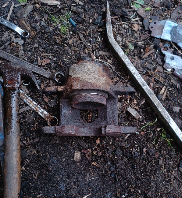

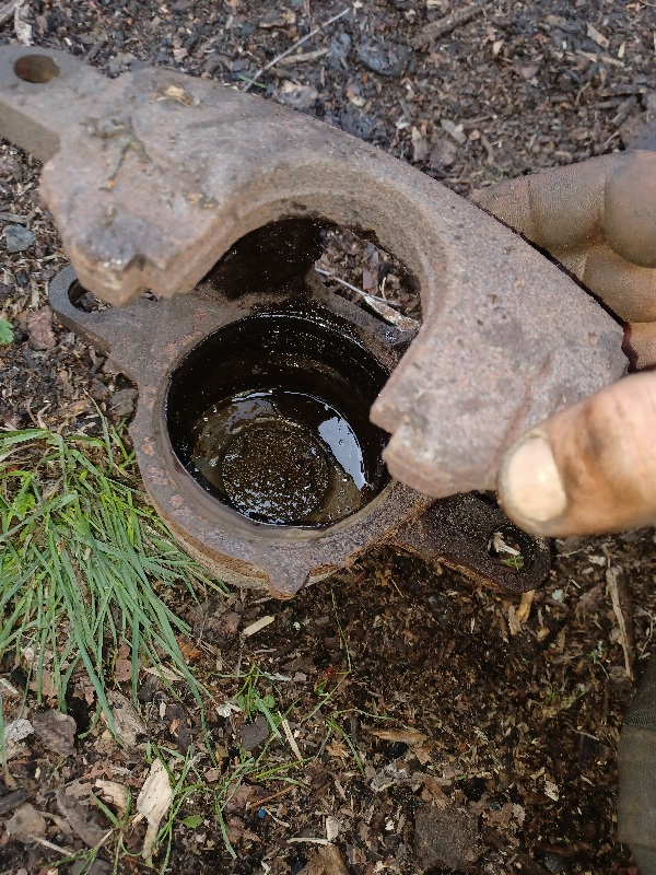

Worked on the Chevrolet also today, started with right front caliper.
Various pry bars later…

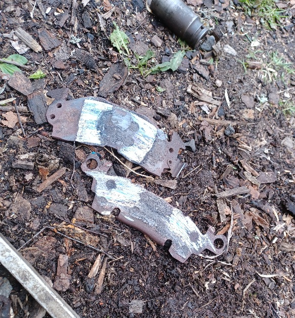

Those brake pads has no more to give…

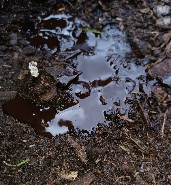

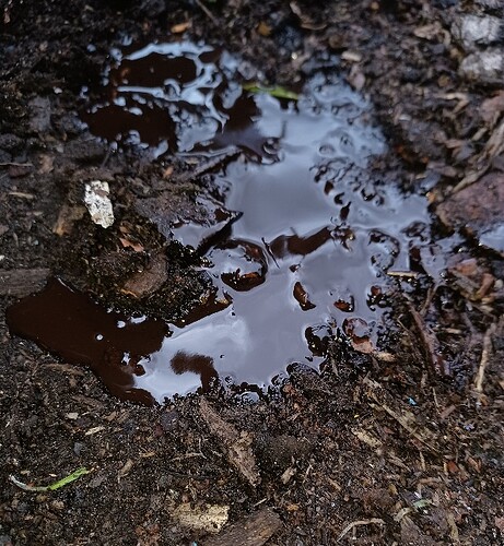

Brake fluid should not be thick, brown, and have pieces in it… good thing whats running from the brake hose is clear.

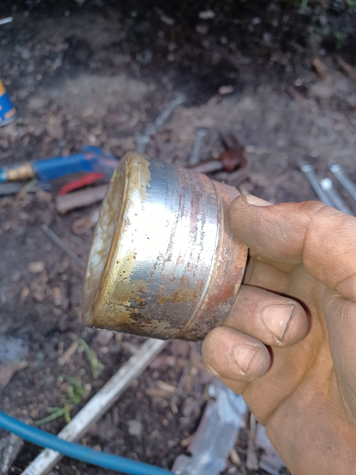

Dmn, 18 bar of compressed air made this “piston” come loose, finally, (i almost sht my pants) the piece of wood i put in the caliper to protect the piston is nowhere to be found.
(Yes, i know, fluid is a safer option as it is “incompressible”, but no one remembers a sissy, and everyone remembers the idiot :crazy_face:)
Now for cleaning and polishing.
I need to order a new (is flexible brake lines called hoses?) brake hose, just to be safe. The old one looks perfect, and no “one-way phenomenon” but there is "Murphy’s law…
O, and i forgot, ill probably need to heat the caliper cherry red to get that evil bleeding-screw out BEFORE i put it back together :stuck_out_tongue_winking_eye:
