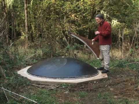

https://youtu.be/9Q_VzJ3P4wc This guy did fiberglass… I really like his design
I saw that one and almost posted it because it was cool but it wasn’t quite what you were looking for. There was another parabolic video by someone else.

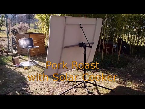

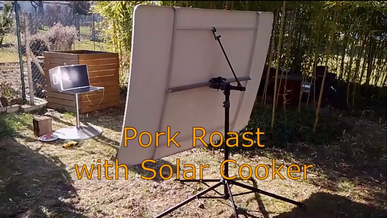

This guy has it all figured out, with tracking, and installed on his deck…
http://www.solare-bruecke.org/Bauanleitungen/2-7-qm-manual-juli-2010.pdf

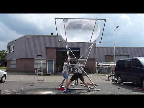

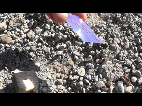

You can use the lenses from the tv’s to melt glass. The bigger trick is going to be controlling the temperature so it is even and cooks all the way through.
Yeah, I am a fan of the youtube channel “Green powered Science” he is a black belt with those lenses… I have used them but one really needs a tracker to get the most out of them.

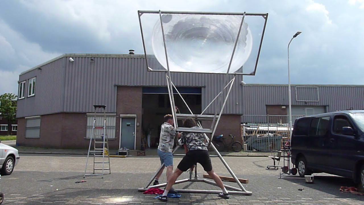

As I think about them, now I am wondering if one could 3d print feresnel lenses… hmmm.
Mr Teslonian 3d printed fresnel lens.
I googled it because someone made a 3d printed microscope for like raspberry pi and printed the lenses. I am guessing you can get clearer, because taking pictures of micro organisms needs a pretty clear lens.
I did a search on projects I found this →
Looking at this the problem is the 3d printer filiment is not clear… I am thinking that the 3d printer could print a mould which one could pour clear resin that could do the job…
These were made with glass / plastic… Now I am wondering what if plexi glass were to be shapped like the light house arrangement…
It looks like they used a resin printer to print the lenses.
The University of Strathclyde developed a 3D printed microscope, including the lenses, for under $60, demonstrating the feasibility of this technology. The team used a Mars 3 Pro Resin 3D printer and Formlabs clear photopolymerising resin to print the lenses. These lenses have been shown to achieve sub-cellular resolution, according to the University of Strathclyde, and can be used in brightfield and fluorescence microscopy
