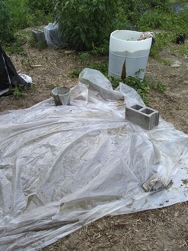

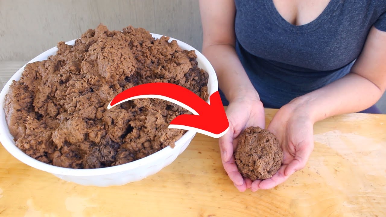

So, I am now trying out making paper crete. never done this before… I decided to run the cardboard thru a garbage disposal. I made a mess the first time around, but now I think I have the hang of this.
First wet the cardboard, then tear into small chunks, run thru the garbage disposal, then dump out on a bed sheet to capture the small cardboard fibers.
I now have the sand, cement, and now will process the cardboard and see what happens.
