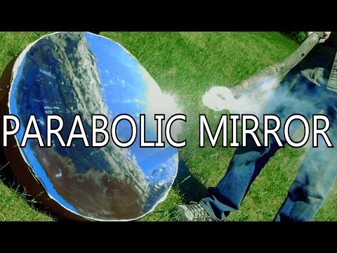

I was trying to figure out how to make a square parabola then after watching this video came to realize a square one is a circle one with the sides cut off…

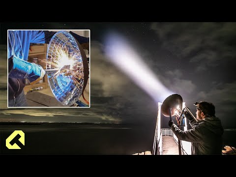

You are better off using either mylar like this guy.

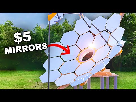

Or using the flat honeycomb shaped mirrors which they use for telescopes. He used a 3d printer and some stuff from pcbway but some of that stuff can be subbed out with more common materials. I think his design is free, and has a whole series of videos on it. And you could probably use mylar over the plates instead of the flat mirrors. And it might actually handle being in the wind better, and if you want to screw around with focal points, it is more frame adjustments, not making a whole new one.
