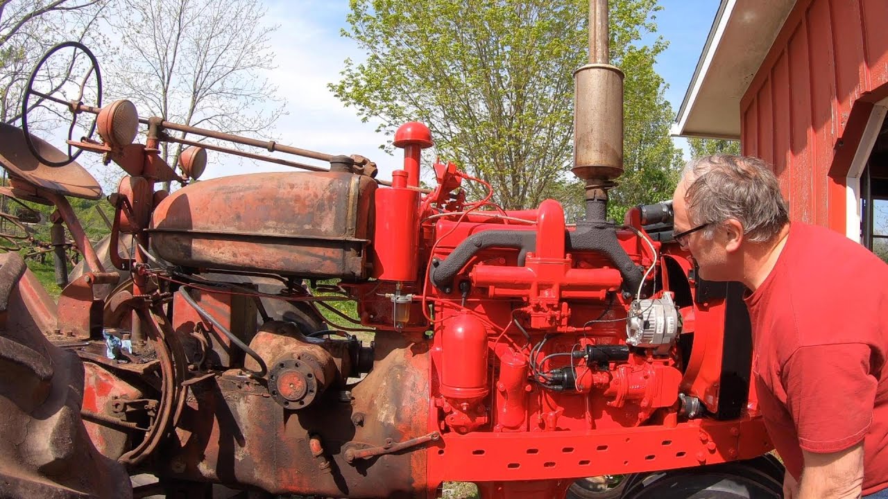

Ok gottcha Tom. I would point to International Harvester. During the 40s and 50s they ran a style of engine in the WD-9, WD-6, TD-9, TD-6 wheeled tractors and tracked crawlers. They started on gasoline. They had a gasoline tank, carburetor, magneto, and spark plugs. Once they were warm, you pulled a lever that switched something in the engine, raising the compression. Then it was a diesel. It had an injector pump and injectors, and burned oil. One side of the engine was gasoline, and the other side was diesel.
I had one given to me, and given to me running because the guy was afraid to shut it off. It needed a starter and he pull started it. Anyhow, in my rush to be deployed to Iraq, I forgot to check the antifreeze. When I got back, the engine was cracked to pieces. It was an MD.
That engine’s spark plugs survived running in a diesel engine.
This video shows some of the details.

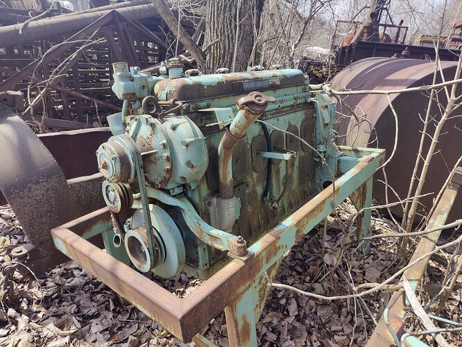

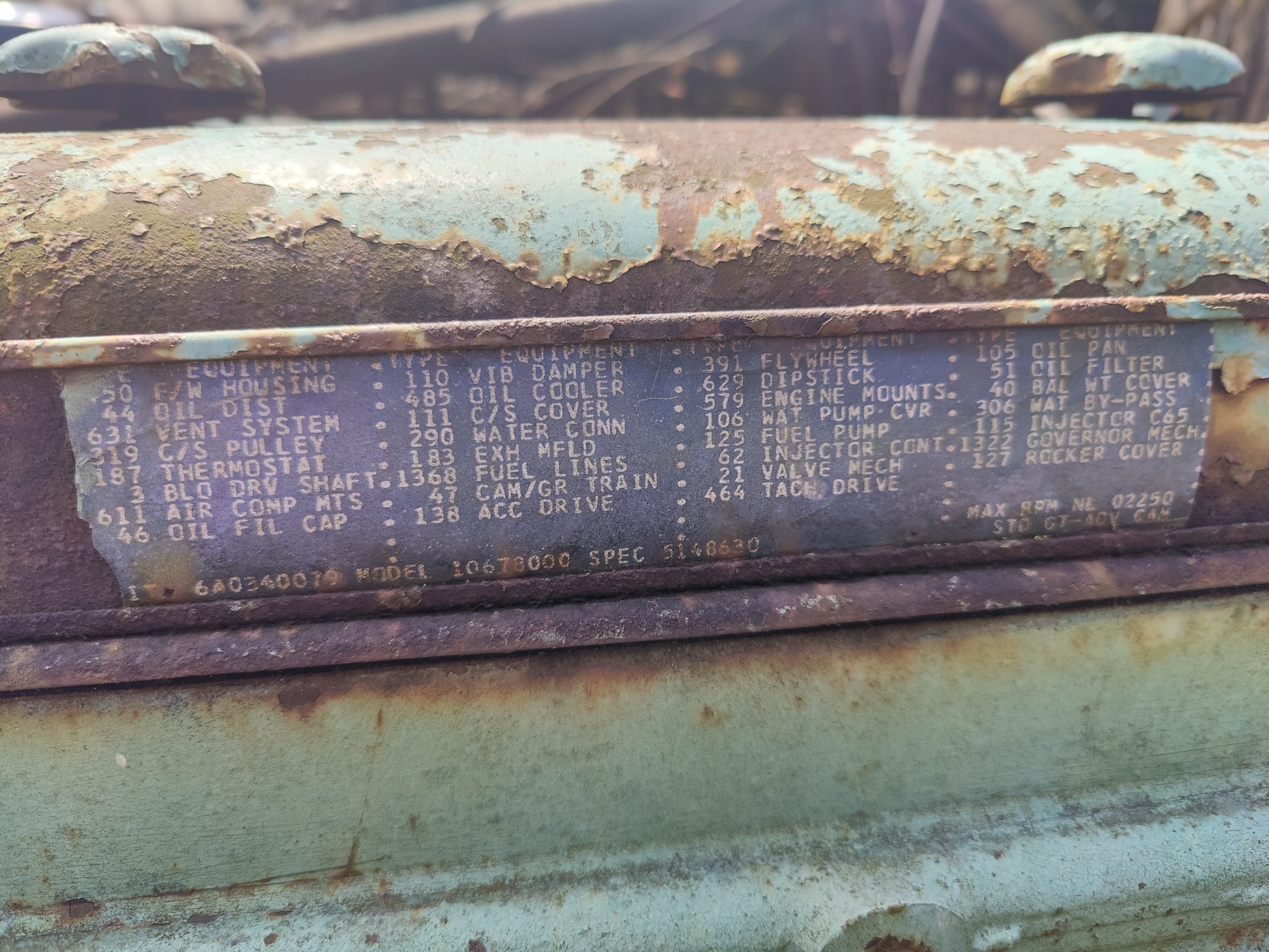

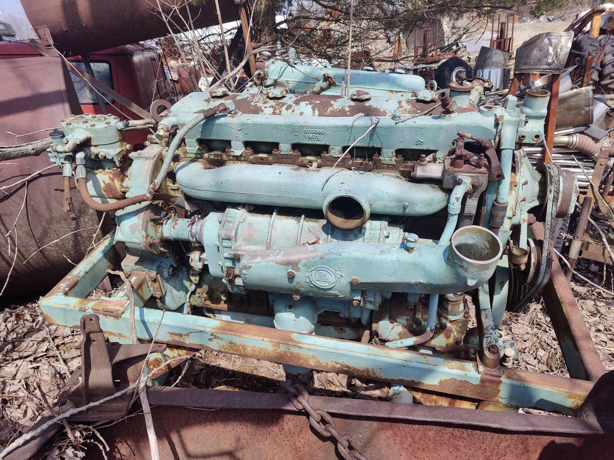

Here are some photos of what I had figured were 6-92 Detroits. The large round cover at the upper front of the engine precludes them from being 6-71 series.
Model 1067-8000 comes up as a 671.
You have some real treasure there.
Well…I’ve owned
(3) 6-71’s and these are different. Even the 3 and 4-71’s I have look like short versions of the 6-71’s. I still have one 6-71 in my Pettibone 5 yd loader. The rear gear housing is different. The front water pump and housing is different. Oil fill is different. If they are actually 6-71 blocks with totally different ends than I am familiar with - I’m gonna feel really stupid. Guess I can measure the length of the valve cover and compare with the one in my loader.
