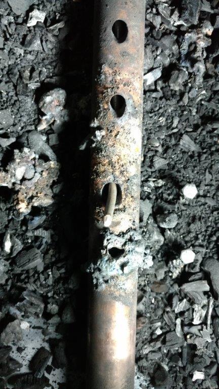

I’m glad you like it. I found out that the brass adaptor that was threaded into the nozzle broke off. I will extract the broken piece and replace with a thicker stainless steel nipple. Once I get my pick up repairs done, I’ll get back to the MG. Hopefully I’ll get back on the road soon.

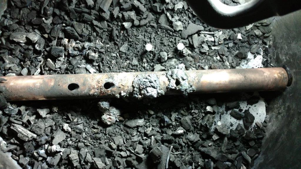

I just cleaned out the reactor and here are pics of the clinkers on my nozzle:
The poker easily removes them:

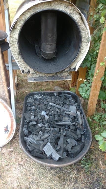

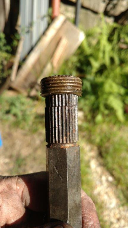

my reactor problem was caused by a brass reducer that broke off inside of my nozzle. I’m thankful that I have internal pipe wrenches:
I hope to fix this part and replumb my charcoal gas return line and flare circuit tomorrow.
OK, Bruce, you got me. I had to look up internal pipe wrench. Darned if I haven’t passed up on these at garage sales because no knew what they were. Sure beats distorting/breaking a pipe with a pipe wrench. Learn something every trip to DOW.
That’s pretty good Bruce , no wear on the holes from what I can see , I have noticed one thing on mine yesterday when I removed it again , because I had cleaned off all the clinkers around the holes last week and replaced it back into place , since then up too yesterday only a small amount of clinkers had built up around the holes and because my stainless pipe is less than 1 mm walled I can see where I have poked my wire up like you do its taken away some of the stainless so now the holes have chips out of them , still nothing to worry about yet though .

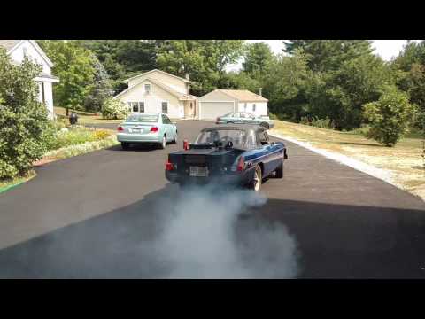

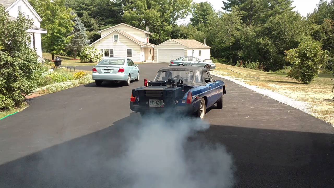

I took the MGB out for a 22 mile run today. Quick startup, good idle and enough power to go up and down hills on a country road in 3rd and 4th gear. But, lots of smoke. I was hoping that it might just be from setting for 14 years. When I returned and did a compression check I got 120, 120, 110 and 70 psi. So now I just have to work up the motivation for an overhaul. I have new flat top pistons that will give me a 12:1 CR. The syncro is out between 4th and 3rd gear so I’ll fix that at the same time. Maybe next year? Here are a couple of videos:

I bet you were so pleased to be able to have a drive in the old girl at last . Although its a shame about the smokey engine its not the end of the world and you have built one beautiful little charcoal baby .
If the engine has been sat around a while and not been run for a while , it could be worth having a look at some of the additives available for oil burning engines and stuck piston rings , valve seats/guides ect , worth watching a few youtube vids to see what you think .
