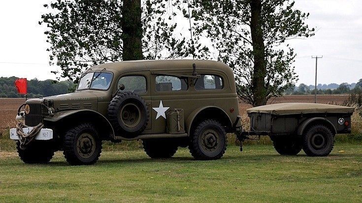

My dad had a '41 model that he used at the deer camp. We called it “The Army Truck” when I was a kid. He could go ANYWHERE in that thing. If there was no road, he’d make one. Rescued lots of Blazers, Broncos, Scouts and Jeeps with that PTO winch.

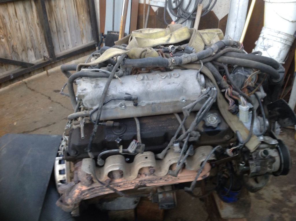

Wayne, my engine is a 96 model, will this work? Also will the automatic transmission work? What is the total weight of the gasifier system?

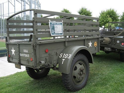

I going to put a smaller fuel cell in the truck, but the entire trailer will be dedicated for the gasifier. The pictures of the trailer combo, and just the trailer are another guys, but the four door and the engine are mine. I plan on building a system that would look somewhat period correct, but with a modern power plant. I have a picture of a tank driving with a gasifier mounted on the back. Mine will be a cruiser that the wife and I can take on a road trip to see some of the sites.
I was also going to make my filter look like an wooded crate stamped with “crackers” or something. Of course everything will be out of metal, possibly some aluminum. The trailer sides will be the radiator. You guys get the idea.

The 96 should work fine. As far as transmissions I really like the automatics but it may be personal preference . All my vehicles have been auto trans except for the very first one I built ( 78 , F-350 ,400 cid , manual four speed) I find when I am in tight places I can hold a little throttle and just a little brakes and make it maneuver well .
The weights of the gasifiers can vary quite bit depending on the thickness of materials Just a guess I think the gasifier system on my V-10 would weigh about 700 pounds . This includes cooling rails , filters , tanks etc.
Just one note to keep in mind . The V-10 is a big slow rpm , high horse power and high torque motor. I would make sure your truck isn’t geared to low for the motor.
My ¾ ton four wheel drive is geared at 75 mph at 2000 rpm. which works well on gasoline but for wood gas I wish it was geared just a little slower . Maybe 65-70 mph at 2000 rpm…
