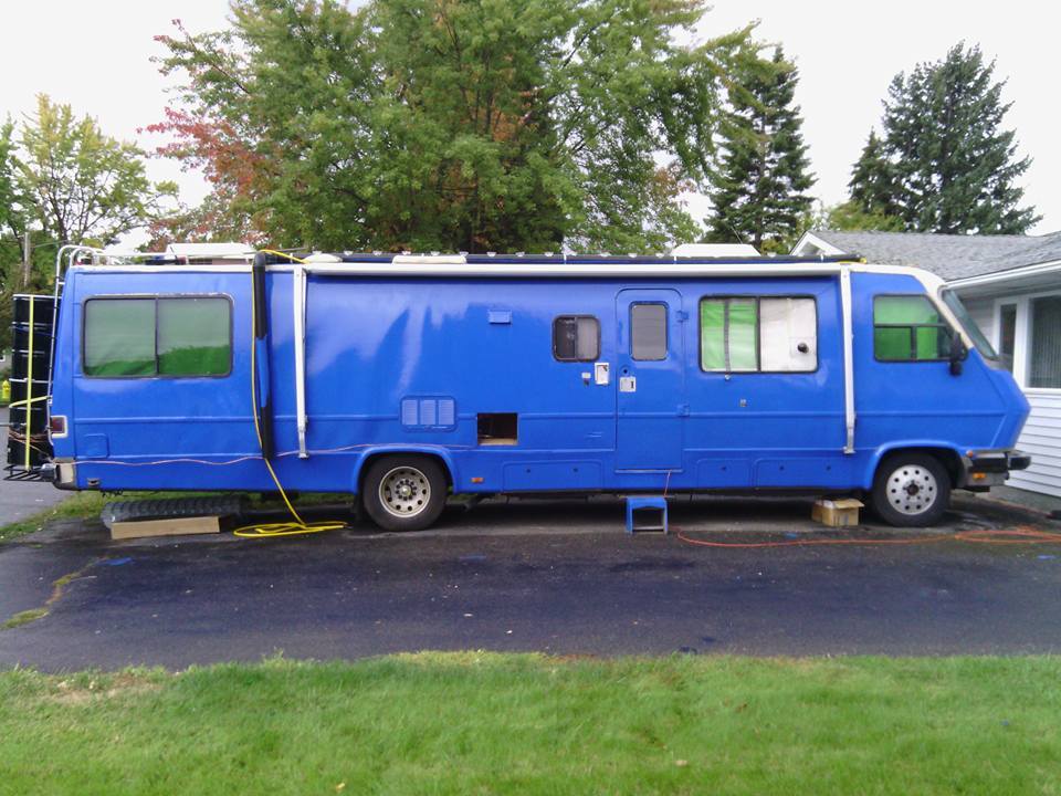

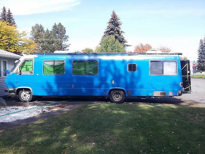

I am trying to make a gasifier that runs a chevy 454 motor on an RV. I have already built most of it. 55 gallon drums are the base. 8 inch hearth. 1/2 inch walls in hearth. piped 4 in to filter barrel. 4 inch fan to engine. any suggestions??

what size of hearth would you recommend. i’m already fully committed to what i am doing. almost done with the whole build. I will provide exact measurements soon. its all experimental so its kinda trial and error. im working no budget salvaged materials. but im thinking 8 inch hearth and 4 inch pipe the whole way might do it, super blower fan. gas shut off. i need a 4 inch ball valve to dial things in but they are very expensive. also wondering of i need to ball valve air intake?
If I may ask, what is your reactor based on?

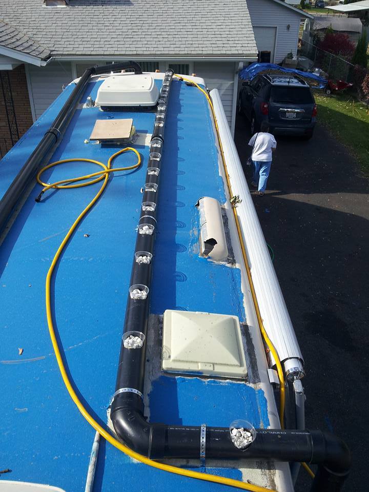

my own design 22.5 inch wide feeder barrel to 8 inch diameter 8 inch high hearth 1/2 inch walls . 4 1 inch ball valves air intake. might need more. down draft design. media filter is 55 gallon drum 1/2 sawdust, 1/2 shed paper. 4 inch DC blower fan. 4 inch inside diam pipe 36 feet long for cooling. 4 foam filters in pipe.
Almost done with this entire project. Pics coming soon. I think it is entirely done. Might need a ball valve to the engine to dial it in. I havn’t even tried it yet. Probably should get valve and alot more saw dust / shredded paper for the filter. As far as the thermo cracker I have all the parts. I just need to fabricate them and put them together. Do you think i need to water cool the gas / diesel , converter. or air cool with copper. Trying to design an auto oil filler hopper. kinda complicated. also wondering what types and amounts of catalyst metal to use to split oil into gas/ diesel. Also thinking of water cooling the entire system to prevent over heating and to get free hot water on demand for my shower / sink.
