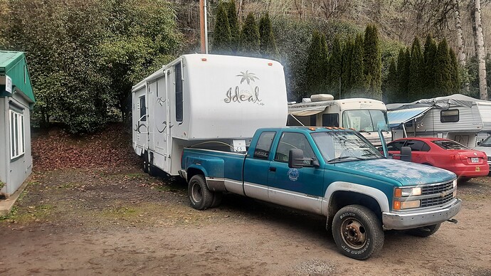

Here’s a photo of the truck. This is part of my business on the coast. People pay me to move their RV’s all the time. I need to be able to pull them and this requires torque. I also need the full bed space especially turning when I have a full size unit attached to the 5th wheel plate. No room for the gasifier.
My idea is to REMOVE the extended cab in it’s entirety from the truck and replace it with a standard cab. It will bolt right up. By doing this I will have a space between the bed and the cab where the gasifier unit could be installed.
