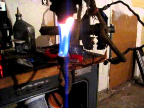

bronco has been converted from efi to carb, ive done alot of syngas research since a year ago. ive looked high and low for a smaller easier way to get around the gas hog problem. its obvious diesels can run waste motor/veggie oil, and its not apparently obvious that spark engines can utilize waste oils as fuel, but if the oil is GASIFIED, then it is possible. ill be experimenting with an oil gasification heat exchanger on my broncos exhaust system. if and when it works out, ill post what ive got
ive talked to sean french about it, we both agree its possible, and theres patents that talk about it, so im about to see if i can build it right and get it working

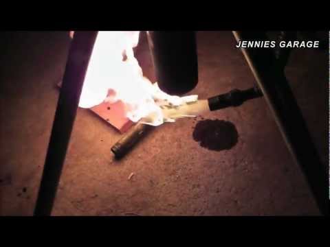

heres a few videos to show what im talking about:
looks as good as any woodgas flare ive ever seen

I’m not sure the videos were the true definition of gasification . The same can be done with just about anything that will burn. Gasoline , oil , grease , car tires biomass etc.

i have successfully gasified motor oil, kerosene, and veggie oil, (will try old gasoline, automatic transmission fluid, power steering fluid, good gasoline, diesel, solvent, and gear grease) then i have been able to light the “smoke”
that comes out of the gasifier, and it burns very well.
im operating around 1200 deg F. 1000 watts, several ounces-1qt, and trying fine mist on the elements. the unit is very small compared to the conventional
wood gasifier, and the output is very large, the whole system could end up fitting under the hood… at 1000 watts consumption I’m getting a 200 amp alternator
with my dual batteries to keep up with demand
ran out of time this christmas break, but with a flammable gas and my electric heating prototype i believe i can get the 460 running on this “oil gas”
i have videos and pictures i will post later, and if anyone wants to try this make sure the feedstock has as little water as possible, otherwise bursts of gas occur
and it sounds like an over heated frying pan
i really don’t understand why more people don’t try this… its pretty straight forward, but i haven’t driven on it yet…
