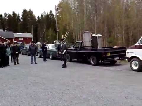

This popped up in my feed today. Our woodgas brothers in Finland. They have a lot of chevrolet products they have gasified.
I honestly wonder if it’s because GM is popular there, or if GM vehicles respond better to woodgas? 90s Ignition computers in GM cars and trucks keep pushing the envelope advancing the timing with the knock sensor.

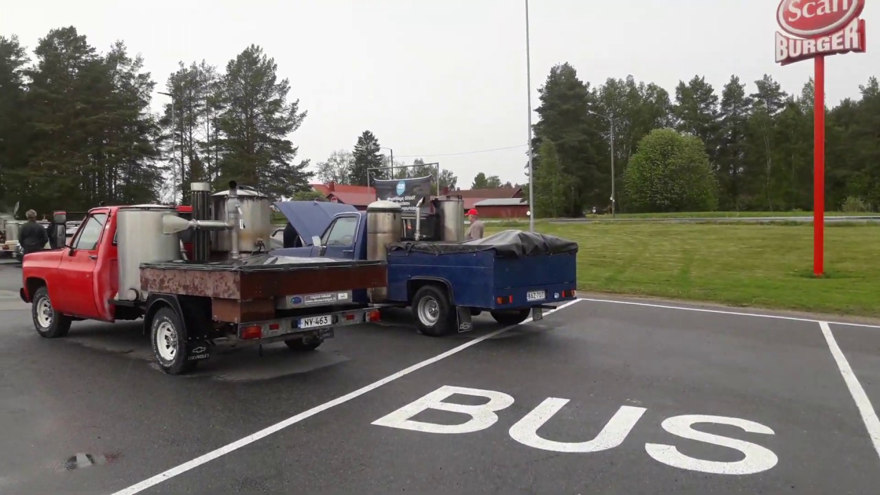

Here is a newer video, better pictures of the gasifiers and there is a Ford Truck in there as well from the same guy. It has to be a group though.
