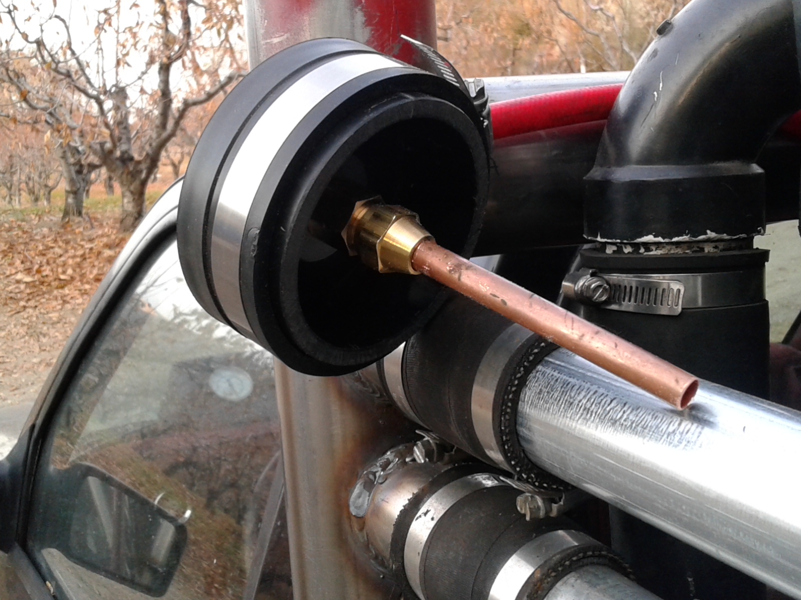

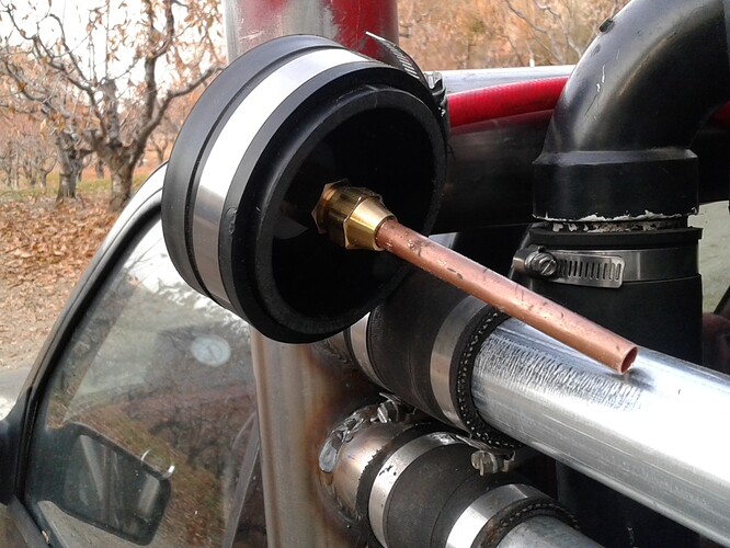

I think installation of a 3” washer holding a 2” thick insulation may save the fernco caps on the header pipe.

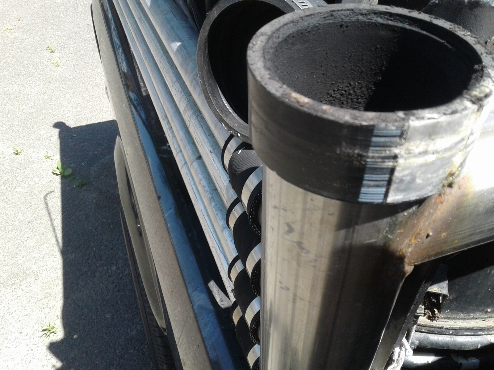

With this long stem hanging down going the direction of the wood gas, any soot plugging problems should be taken care of. My line plug up a couple times at the tree connection fitting.

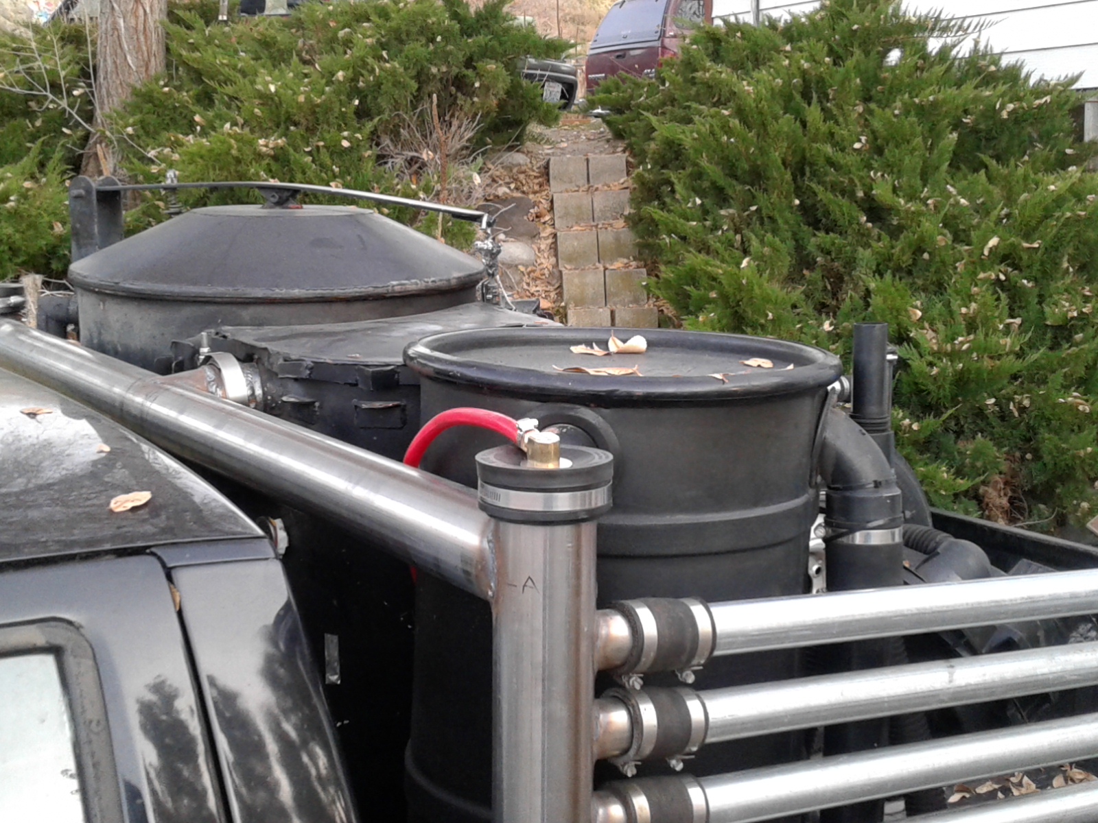

Well this project is finished. Now on to the back bottom condensation tank, it is getting pretty rusty thin on the bottom of the tank. I am not sure I realy need that big of a tank under the back of the truck. What do you guys think. I could cut 1/3 rd of the bottom of the tank off and still have a lot of room for soot and water to collect. The wood gas is not hot by the time it reaches the tank maybe a big plastic pipe with end caps, and bibs glued in for the intakes and outlets. It sure will not rust, that is for sure.
I used a large ammo can for the rear condensate tank that seemed to work well and is very easy to clean out. The needed amount of room in the in the rear condensate tank is much less than those big tanks.
That is some awesome work Bob!! I don’t drive my truck near as much as you under folks do but my experiences is that the hopper condensate collects more than the rail condensate. Most of all I’m burning is kiln dried construction lumber. I think Gary from Missouri has some big plastic condensate tank for the back👍
The other factor is ware the hopper condence tank i located, my last truck set up had the hopper drain tank too close too the hopper and heat exchanger, and i got very little moisture in the tank, Too close too the heat, better mounted like waynes book, or under the truck away from the heat ware it will have a much better condenceing effect.
Good morning Mr. Bob
I agree the rear tank is bigger than needed for condensation and soot but if I have a tank handy that will not take much time to mount I will continue putting them under the truck.
One other reason for the tank and also the huge hay filter ( filled about half with hay ) is a fuel storage . When stopped at a stop light idling l will have enough fuel to stay with the flow of traffic when the light turns green.
Thanks Wayne, that is something I did not think about, wood gas reserves in that tank. I will be keeping most of the tank reserves then. I think it is time to check the new cooling header rails, with a tomorrow run down the road. This 92 Dodge Dakota needs to be running on some wood gas again.

I drained of the fluids in the hayhopper, none, and the back condensation tank, none. The tar/condensation tank, Oh yes. Open the 2" drain and drained the black tar goo out too. The truck is ready for winter.

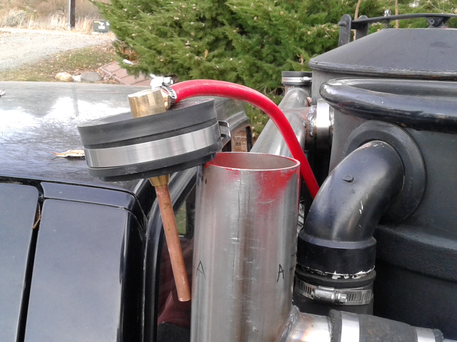

Hey Bob, I got some 3" Fernco caps but I noticed they’re too big for the 3" exhaust. Makes sense because the Ferncos are for pipe with thicker walls. How did you make them seal up? I saw some extra stuff in your caps in the pictures. Radiator hose? A cut piece of Fernco?
Edit: for the time being I found some silicone hose that fits the 3" pipe tight and bridges the gap for the fernco caps. I might bolt in some fender washers to act as a heat shield.
