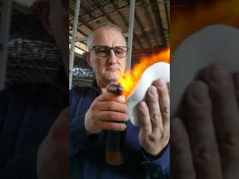

Strange but just recently i have been bussy with this kind of stuff. This one made from rice starch residue from the waste water plant… otherwise it goes into animal food…
That is pretty strange Koen!
after you had carbonized the surface of the material, does it feel crumbly, or might it be rigid enough to surive in a gasifier firetube?
My guess was a one time safety use material. However, it might be possible to heat cure then protect with ridgidizer or kiln wash. So easy to make, even for me.
And pretty cheap. :slight_smile:
Product , as shown in my video, is 100 Gr of rice flower, 20 gr baking soda and about 50 gr white latex glue
It is not suited to act as insulation but works well as fire protective layer in case needed any.
The carbon will withstand up to 4000ºC as then it will sublimate ( any carbon ) or glow into ashes
The baking soda will make “layers” or bubbles that will create a kind of barrier before the real heat can reach next layer.

This material start as dry paper mache like
It reacts to fire in the way as you see on the video
However i did not test it further as a sole insulation material due to it properties.
