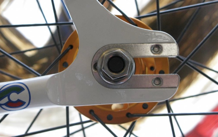

Tyler; When my shop burned up I just through all the tools in my chest into buckets. I spent some time today looking through them for my chain breaker. No luck. Since you have taken the crank off your bike and only have one chain to contend with, I don’t know why you aren’t breaking the chain and taking out how ever long a section you need to to get the chain to fit tight. If the mouth of the slot the rear axle fits into is facing the front, you start with the tight chain right at the mouth and you will be able to tighten the chain as it stretches, towards the back of the bike. The opposite is true if the mouth of the slot faces the back of the bike. The axle starts out tight where the slot ends towards the front and again as the chain stretches, you move it towards the back.TomC
PS Are you old enough to ride a motorized bike and don’t you need a license plate on it. My personal opinion here is; if you want to get into woodgas, get a riding lawn mower and convert it to woodgas. Several of the older fellows all start with riding lawn mowers. You will learn a lot, and your folks might be happy that you will volunteer to mow the yard while making trial runs with you "gasifiera’
The slot is at an angle, too awkward of an angle for it to practically make much difference in the slack of the chain. If I could I would provide pictures but I am as of now in Kentucky for my brothers baseball tournament. Here is a picture of what is ideal for my setup, but what I have is in the picture below:

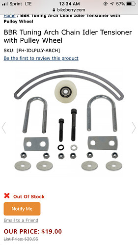

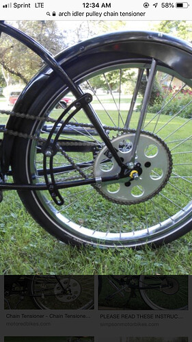

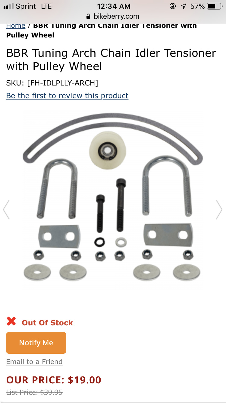

I have a cheap solution, for 20 dollars you can purchase this arch tensioner that does not rely on one circular bar to keep it in place. It is made for cruiser bikes with the 66cc motor on it, so I think I will just purchase something like this
FACT CHECK TIME!!! First off, this group is made up of DIY ( Do It Yourself ) people. You DON’T have a gasifier built. YOU build it. We think through problems and build the solution. (Even if that tensioner is only $19 we would build it ourselves-- maybe with improvements). Don’t have the tools or a machine shop. It is a good time to start collecting tools. I see that tensioner being built with a saber saw with a metal blade and a hand drill. Sure it will take time and may not be as fancy as the one you can purchase, but YOU made it and most of all you learned doing it.
