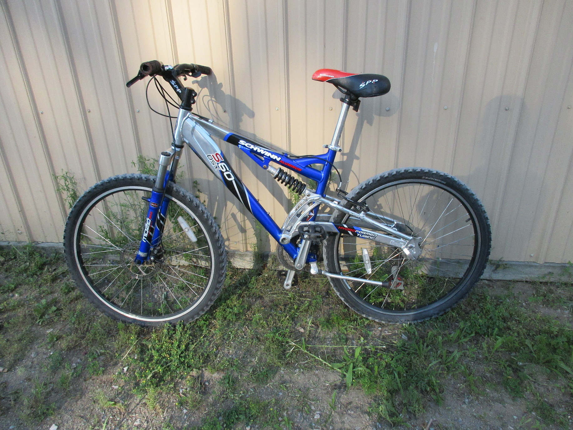

Ok so all this talk and I knew I should not have gone to Craigslist but out of curiosity I wanted to see what was out there and I found this gem for 50 bucks. Bent rear rim and the derailleurs need some tuning. Im going see if I can straighten the rim and it does need a new tire. So Amazon for that. This has the rapid fire controls, the other free bike has the twist grip and I dont like them. Back in the day I was an avid mountain biker. I had an $1800.00 bike and this was back in the late 90ās So this was a very high end bike. I rode that thing everywhere and then they gave me my license back!! aint touched a bike since!! lol
So I got this now and am now committed. Im thinking of getting a mid drive for it.

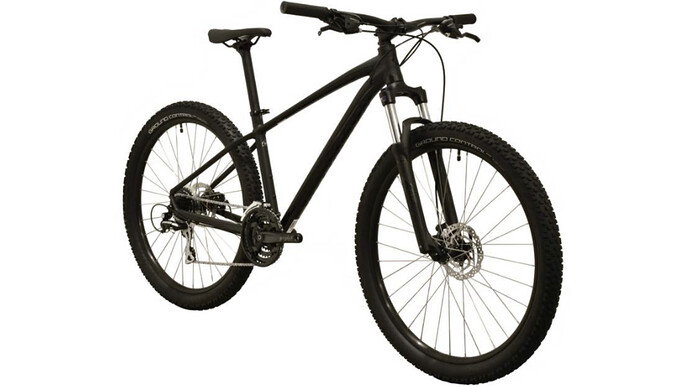

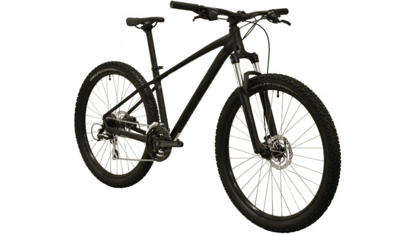

I bought a new bike today, the original thought was to adapt it to electric with some kits Iāve seen online, but now that I ride it, it is very comfortable. It would be really cool to convert it to electric, but I think that it is built really well as it is and can serve as a good mountain bike for trails and such.
That is the bike, not the exact bike but the same type. It is fitted perfectly for me. It is just expensive when it comes to batteries for an electric bike, because the lead acid rechargeable batteries, all 12 volt and connected in series, is heavy, and the lithium ion batteries and some other smaller batteries are just as expensive as the bike!
I have decided that I am not going to do an electric bike build with this bike, and I am just going to use the bike for normal biking. It is not practical to spend the money on a whole electric system.
