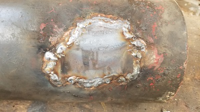

I have started working on a char lawnmower. The deck was doesn’t work but I have a trailer for it so I can use it for hauling. I built a a fitting to tee in to the intake. I planed to use an old tar tank for the gasifier. Today I patched a hole in it and cut the opening for the fill up.
