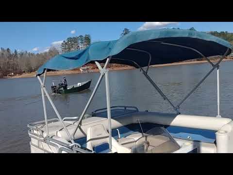

I am trying to upload a video. we took it to the lake today and It worked.
I would say we traveled about 8 mph if I had to guess. I am really glad I upgraded to the 420 cc engine I am pretty sure the other would never have been able to push the boat. It still needs some work. I will try to upload a video when I can.

I just want you to know you do not need to go that fast when trolling for Walleye. A 1/8th of that speed would be just right. Congrads. well done. That boat scoots right along.
That johnboat is really going at a good clip, looks like 5 knots give or take.
