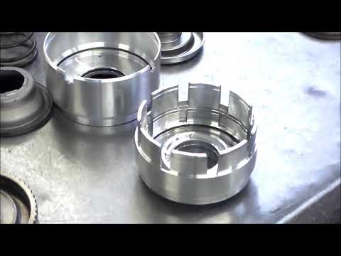

Every steel has heat discoloration and all the clutches look about the same. I believe this is the reverse pack from a diagram picture I found online but not certain it is the only problem I have found so far
Hello Jakob, the automatic transmission works by applying the pressure of the control oil to the hydraulic cylinder, which compresses the lamellae of a certain gear. This pressure is approx. 10 bar (can be more, depending on the gearbox). If you look at the path through which this steering oil flows to the assembly of a particular gear, you can find that there are many possibilities for leakage, the high probability of failure is a leakage of steering oil pressure. Outside, somewhere in the gearbox housing, there are measuring points where the oil pressure for each gear can be measured, if the tightness is good, the pressures are the same, but if the pressure is lower for a certain gear, there is overheating and wear of the plates, well, by changing these plates will not fix the problem.

I talked to Steve Unruh also and he said the same thing. I ordered a Mopar rebuild kit so next week I’ll try to overhaul it and hopefully that will fix it. The transmission only has 83,000 miles on it so hopefully no hard parts are worn too bad. I visually inspected everything I had apart and didn’t see any problems with the hard parts. But I don’t have much experience with automatics.

according to this…
2 common issues for that.
- In the Compounder the low drum snap ring groove breaks, do not keep driving the vehicle because the parts that break off cause metal to move throughout the transmission.
- In the Compounder the low drum Teflon sealing rings rotate causing the grooves they ride in to widen. In both cases the low drum needs to be replaced with the newer updated model.

Hey guys thanks for all the help. I went ahead and ordered a rebuild kit for the transmission. I bought a Mopar set off of eBay. After I tore into it more I found a broken hub. It was one of the pieces that came in my kit so that was great. I went ahead and rebuilt the transmission. Either I messed up the front seal on the transmission when installing it or it was defective. I ended up having to pull the transmission out a second time and replace the front seal. I reinstalled and it is all working great now. I found a guy with a good series of videos on YouTube that I watched. He went through step by step with this transmission. It was very useful.
