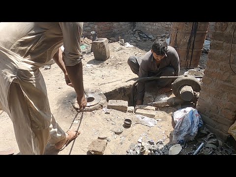

Maybe other folks have seen this, but I have never seen someone with a flask split vertically. He is making a giant v-belt pulley
