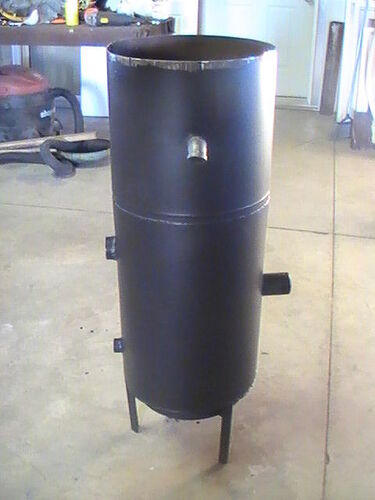

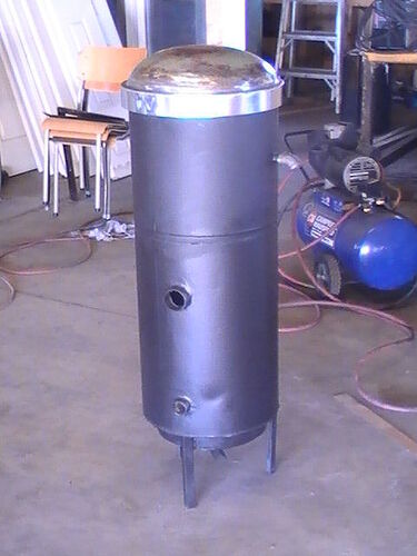

Air jacket on and it’s got legs again… more welding and finish the lid… sure would be nice to burn this in the next few days. we’ll see

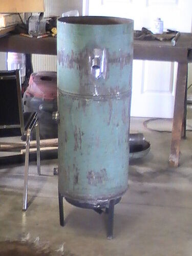

got tired of looking at the ugly old paint so I did a bit of grinding and threw some bbq paint at it. looks much better now.

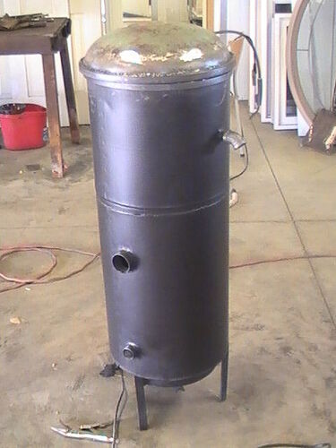

Hi Sir. Does your pre heat air pull from the entire bottom of the unit and the outlet gas pull off the inner tank that is sealed from the outer air jacket? This design looks slick… coming from a rookie mind you but a fairly well studied rookie at least.
Thanks for any info… just trying to pick the brains of the pros to at least limit my first disaster.
I appreciate the simplicity of Wayne’s and your design. To the point and well functioning. I was hoping to start with a design for small engine use before I dive full on to power my truck or a donor truck I should say. I drive a Duramax at the moment but have a 460 Ford engine in the back yard that hopefully will end up wood powered.
Also… is the design of the nozzle angles and hearth meant to keep ash deposited as insulation? Rather than just a flat plate restriction.

bottom of unit is sealed. there is a port near the bottom of the outer vessel that lets air in. top port on same side can be used for lighting.
a few pictures above is a drawing that i’ve based my geometry on. if you are looking for a simple unit that works it would be a good place to start.
