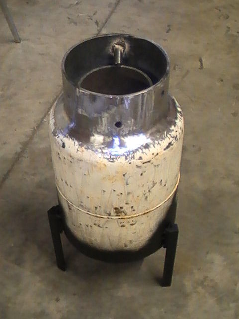

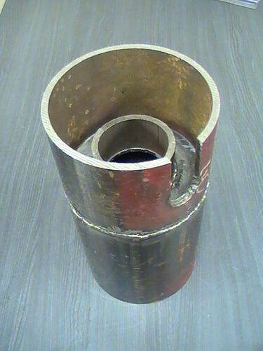

Not that I don’t have enough on the go already. I started another small build, again based on Stephen Abbadess’ Victoria.
This is the inside reactor area of another small gasser build. 3" restriction… this will go inside another 8" tube. The slot is for the lower nozzle (based on Stephen’s Victoria) top row of nozzles will just peek over the top part of this tube.
I’ll try to post more pics as I go.

I have my nephew Josh giving me a hand today… he gets to do all the fun stuff like grinding…
My nephews handy work… he cut and welded the bottom flange, made the bottom, indexed and drilled the holes, installed the grate and adjustment handle.
Not bad for his first kick at the can.

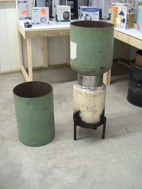

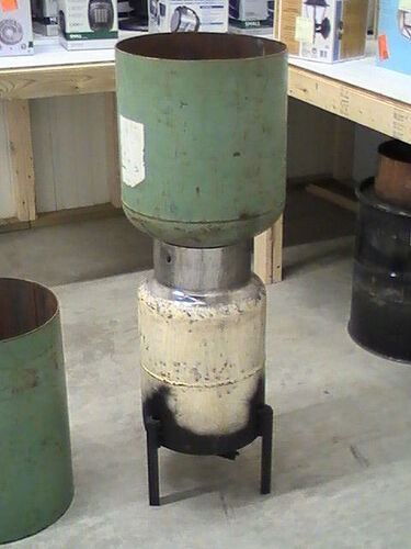

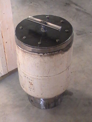

so what’s 12" round, a little less than 24" tall and weighs 93lbs? our lil hearth as it sits right now… I guess it’s made outta something
Morning Arvid,
I started to say my wife but she is not that tall!

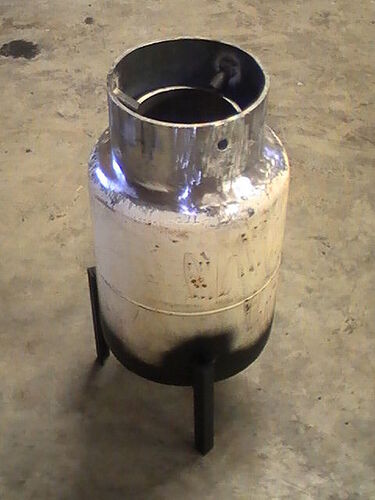

Added some temporary legs to the unit so i can work on the top again. Gotta get some plate steel for flanges to build the hopper next, and of course i ran outta wire for the welder… dang…
Need more wire for my welder… and some plate steel… and… and… and… the list goes on.
Thanks for the continuing picture updating ArvidO.
I am beginning to really see the design characteristics that I never could pick up on with just the worded descriptions.

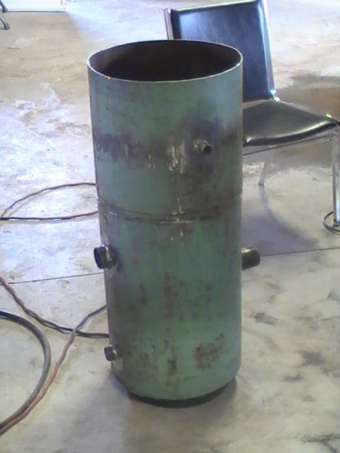

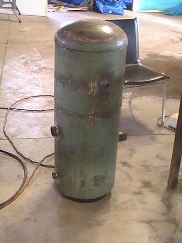

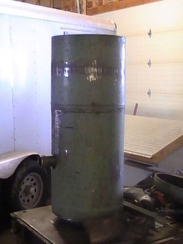

Slowly coming together…
lil more welding done today…
Looking great!
Though I have always lit our gasser top down i thought it couldn’t be a bad idea to make a place where i can light it through the bottom nozzle… looks like it should work… proof will be in the pudding though… so we’ll see once it’s done.
