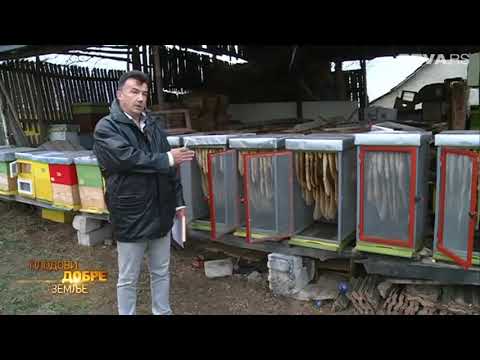

I stumbled on this video few days ago. A Serbian beekeeper ingeneer
Crazy. Throws anything l ever imagined of beekeeping on its head.
Its a lot of info to translate but lf anyone is interasted, l will do it.
In short, he experimented with those fully or partialy open hives last two years. He reports bees have no problems handleing temps under -12c for long periods of time, with record being -22c. He reports bees use a not a lot more honey and queens start laying earlyer thain in closed hives.
Its a experiment to see how the elements effect bees and their survival. He shows exessive hive insulation can do more harm thain good, since it can prevent moisture to evaporate.
I admit that moisture is a problem for hives grown in cold regions like mine
but I doubt that a colony of bees will survive a northern Canadian winter without protection from the cold
I am amazed by that video and will watch it again! I wonder how he gets the bees to start building a hive in such an unprotected space. I would think the scouts would reject it unless he fills the hive with comb previously drawn out in a “normal” hive.

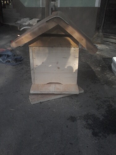

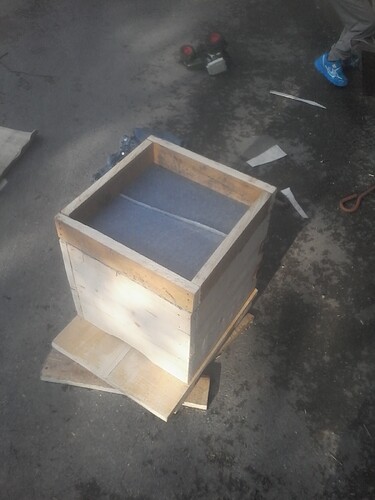

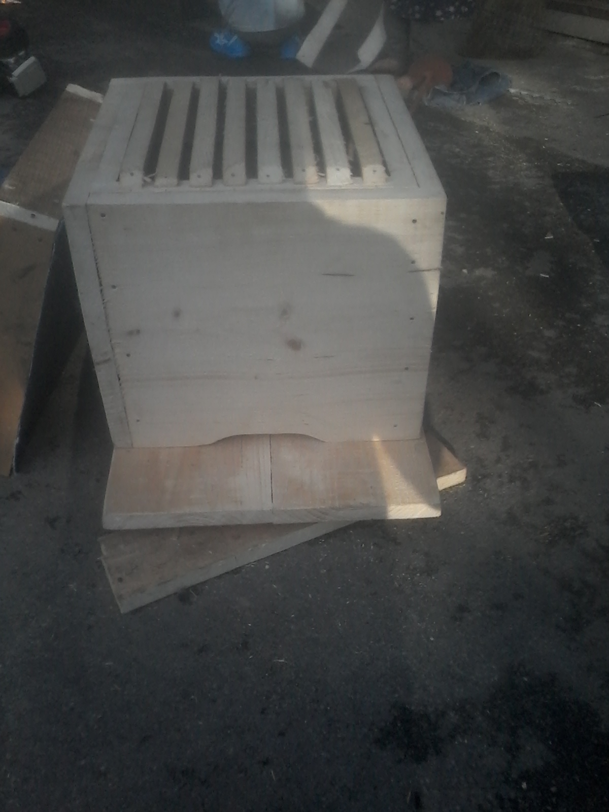

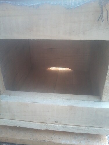

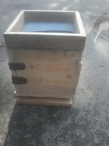

This hive has no frames and no fundation. Just fixed bars on top with a bead of wax. This is to achive several goals:
alow bees to build long deep uninterrupted comb wich both alow beter winter survival and beter bee comunication.
alow bees to gradualy build spaller and smaller cells wich make smaller bees that hach sooner thain varoa does.
boost the temperature to a point arroa doesent like
esentialy this hive is closest to bees natural habitat, hollow tree.
The hive has 2 “bee boxes” (only one for now) wich are never interrupted. Idealy always full of honey on top. On top of the bars a honey super is installed in time of nectar flow, all that may be harvested.
What l did different thain the original design is make the walls out of 2 inch boards so 2" thick and install a door on te back side.
I installed a artifcial swarm and today l checked them, 8 combs built nearly to one half the box, caped brood seen on the edges. Looking good!
Edit: l checked, l lnstalled the swarm 24.6.2019 so thats 23 days ago.

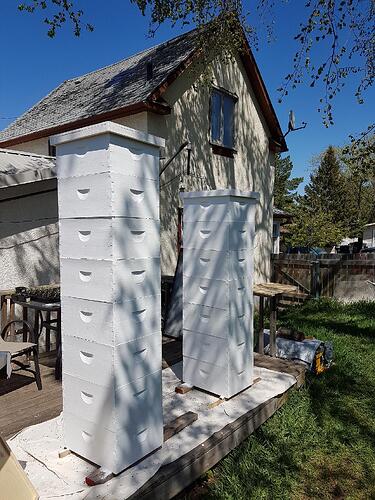

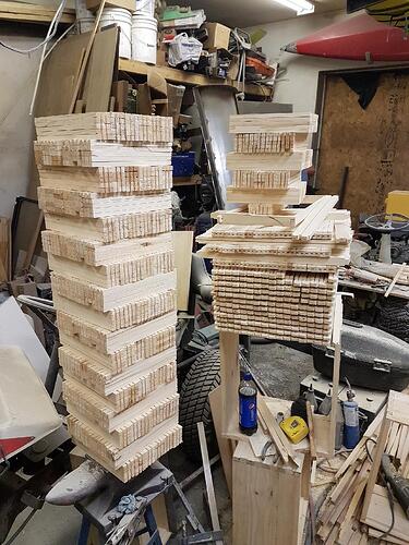

I’m just a complete amateur, but this spring I bought 2 Australian nucleus colonies. I split the stronger one, ending up with 3 nucs. Although the bees arrived April 21, it was hardly spring here, zero flowers or even trees budding for pollen. So they had a hard start, first having to raise their own comb on wax coated plastic foundation. I followed recommendations that uniform foundation reduces drone production, and no doubt helps the bees get started. Plus, in standard Langstroth frames, they should last a lifetime of extraction and handling.
Before nectar flow really got going, the hives were consuming 2kg sugar made into a 50% syrup daily.
After their stay in town, they went up north 240km to their bee yard. Bears are almost as common as the deer, a 6 strand high tension fence is not optional. Also good to keep skunks out, apparently they like to eat bees in the night. A spike board in front of hives will also stop that.
They are doing well in their location, the strongest hive has 4 supers for brood, and now a queen excluder and 5th for honey production. My land was suffering under a severe drought since the end of June, but the weather patterns have shifted, it’s starting to rain, so nectar will flow, the bees will be in their glory. By chance a neighbour planted canola, so apart from the prairie and woodland flowers they will have ample supplies across the road.
I made alll my own gear, frames from scrap lumber, turns out bees are a lot of work to get set up…
