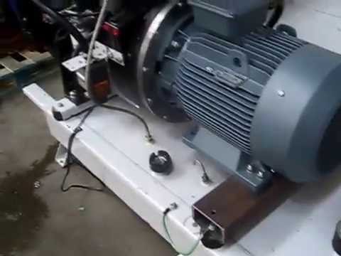

to each other or to your Utility?
This is one way to do it.
Ashley means running generators in teams. In Parallel
Ya I don;t see an advantage to that.
