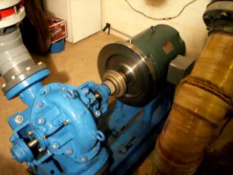

If the motor works fine as a motor, it will work fine as a genertor.

You need a utility connection to run a reliable Asyncronous generator.
The Utility provides the master sin wave and the Induction motor follows that.
Without it you get wild swing of voltage and frequency if you try and run it as alone

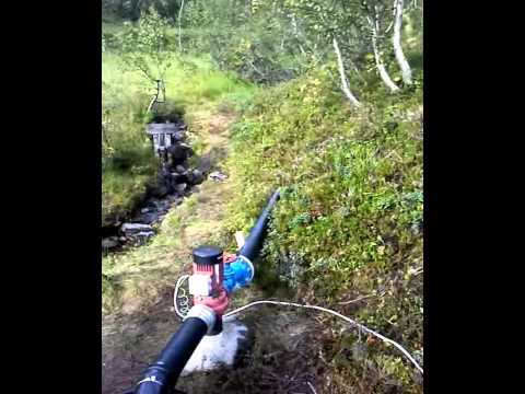

I might not have this right, but this appears to be part of a three unit small scale plant near North Bay ON.
Its generating a considerable amount of good clean electricity from hydro for a tourist camp.
There is a better video and I took some pictures of the place about 10 years ago whilst working on a similar but smaller installation for another guy
heres a tiny one…

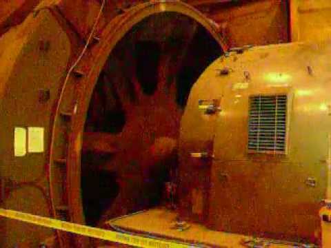

This is one phase made from 6 phases…
The 6 phases are made from 3 phases in a trick transformer…
And now you know where AmTrack gets the 25 cycle they run on…
Its called a cycloconverter.
If worked on this before.
This is a little different but has thyristor stacks that did many of the same things.
It was however making 700 VDC for this exact 7000 hp motor using a pair of Silpacks slaved together and 60 deg out of phase.
