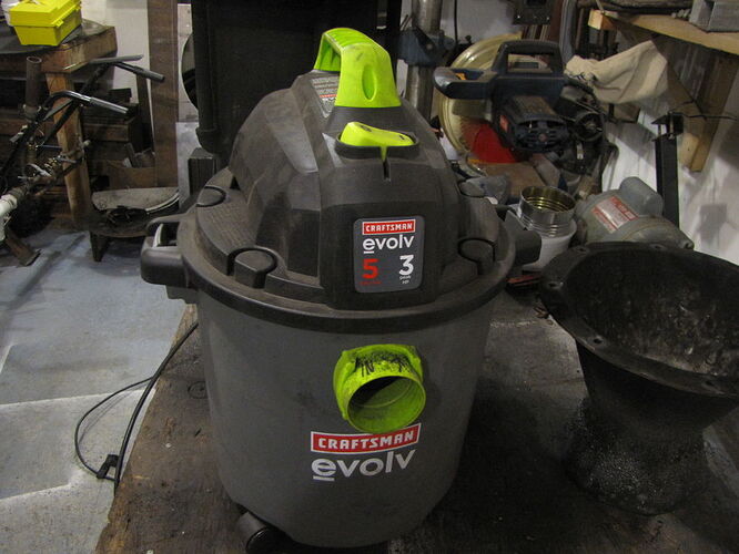

Welcome to the site. I’ve been using this small vac (120 VAC, 7 amps) from Lowe’s ($20 something) for about 6 or 7 hours so I can’t attest to its long time value. So far, so good for my purposes. I like that the incoming air is filtered before it enters the rotor area or motor cooling. I am impressed with the filter, so far. I may remove the rotor assembly and make my own housing to run it on a 12 volt motor at some point. Someone on the site mentioned that Ben from VGW may have tried this. Check the vac out in action here:
