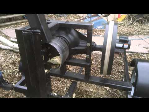

Bill , looks you did a mighty fine job on that chunker . I watched the video & that machine is not even straining to cut that heavy wood.Good work Bill…

@Calvin_rader, thanks Calvin. I shut the motor off and it will chunk 3- 4 more pieces at 3" diameter before it stops. I would like to hook up my wood gas lawnmower to run this now.

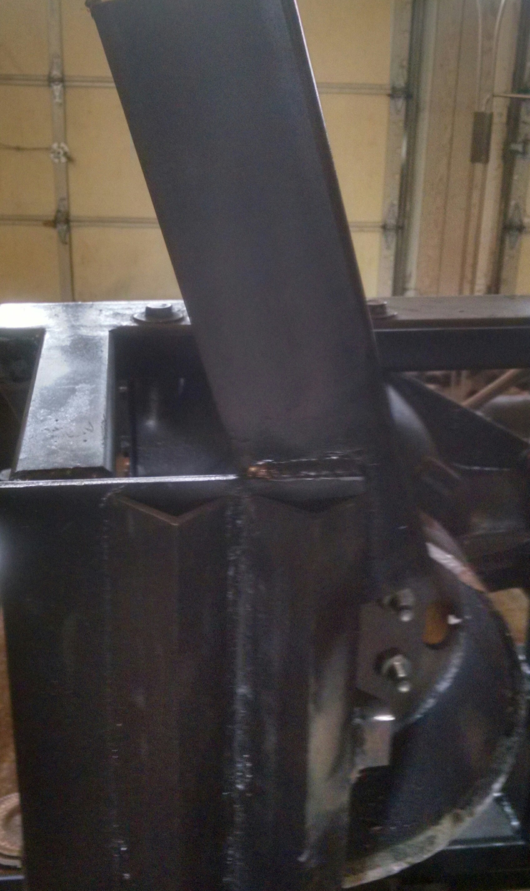

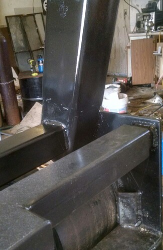

Here is the gravity feed tube. It shears quite well. I put a weld bead to the anvil to make sure of it after my first test run. I was able to gravity feed and feed from the side without any negative effects from the motor.
If I feed a branch halfway in the side and throw the remainder in the top, I can grab another branch through the side again and keep repeating the process.

I think you have a good idea of the small vertical shoot. I followed your thinking and also added a small shoot for gravity feeding.

I like it Wayne. Did you also add a stop inside? I put my verticle tube at an angle. I felt it would keep the branch to the cutting side and I can load from the same side I’m working on. Now I need some chunking hours.

Mine is almost vertical although it may have been better to put it at an angle. I don’t plan any big wood going in the top shoot, just small time consuming pieces .
Yes there is an adjustable stop under the shoot. I have it preset at about 2 inches .

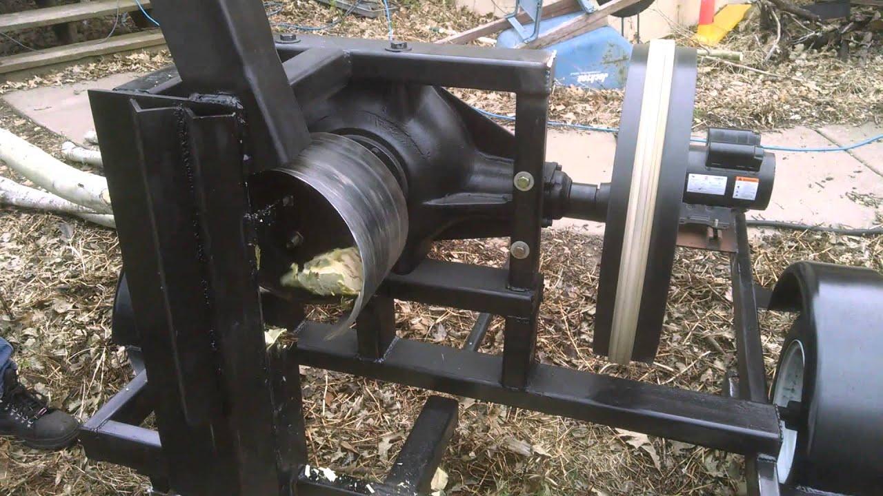

Okay Joseph you motivated me to finish this up today. I wanted to get it done enough to move outside.
After watching the video I see what I need to do to accommodate thinner branches. Over all I am very happy with the operation of this chunker. It will take a few tweaks here and there as I get more time using it. I am open to suggestions if anyone sees something I should do.

Well that didn’t help the itch to build one… What size motor r u using there, single phase?
Looking good there Bill ! That think really gets after it.
It’s a single phase 240 volt 5hp from a Ingersoll-Rand air compressor. I’m impressed when cutting two pieces so close together, it doesn’t phase the motor at all.
As found out on the Friday Hangout, not all 5 hp motors are equal. But I think a 3 hp would also be sufficient. Chris runs his with a 2hp with a slight slow down.

I think the lower amperage of the 240 volt is the key factor. 120 may make too much heat. Hope to see it at Argos, id like to give it a whirl
