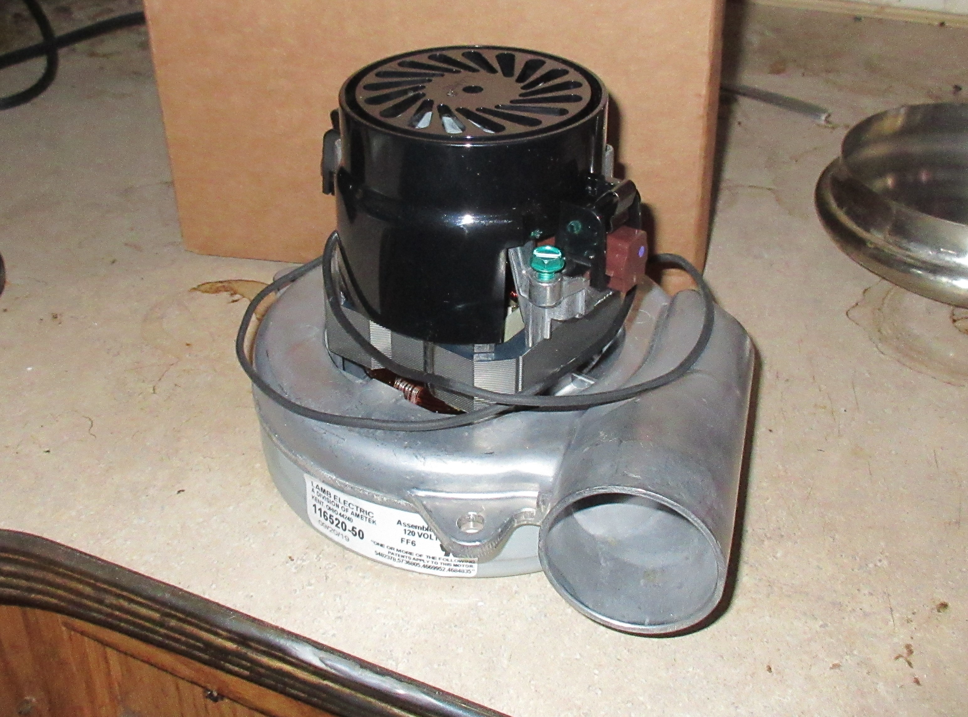

Well, well, well, looky at what showed up today. This here is the Lamb 116520-50 Blower!!
So far out of the box this thing looks to be very solid and the housing is fully sealed!! I had feared there would some leakage, there is none.
Ok so this is AC, the beauty of this; is it can be both AC or DC with simply implementing a small inverter to drive it from a DC source. Battery dies?? no problem fire up the genny on gasoline and plug it in!!. Best of both worlds.
It will be a while before I have a gasifier built to test it on, but Ill at least get a cord wired in to check out the output. Based on videos these things look to be quite powerful and will get the job done. Cant wait to never have to build my own blowers again!! :fire:

I went to Harbor Freight and picked up a cord, router speed control and 400 watt continuous inverter. This blower is a beast!!. I probably wont ever use the speed control on a machine but get it just in case I wanted to experiment with engine boosting.
The 400 watt inverter does not even flinch running this thing. It might be able to get away with a smaller one but need to find the spec’s. The spec sheet they sent I would need to micro scope to read it.
Yeah that definitely looks like it will get the job done.
The specs I found online say 680 watts, So this must be the start up watts Im assuming. So this inverter must be sized about right. Capable of the peak start up watts and then running watts.

I dont know its been many years since Ive seen a Kirby. This is a vacuum blower motor it is one of many for in wall installations and it is very powerful. I bet its at least 10 times the vacuum of my own built blowers.
According to the spec sheet it pulls nearly 50 inches/water @ around 90 cfm.
