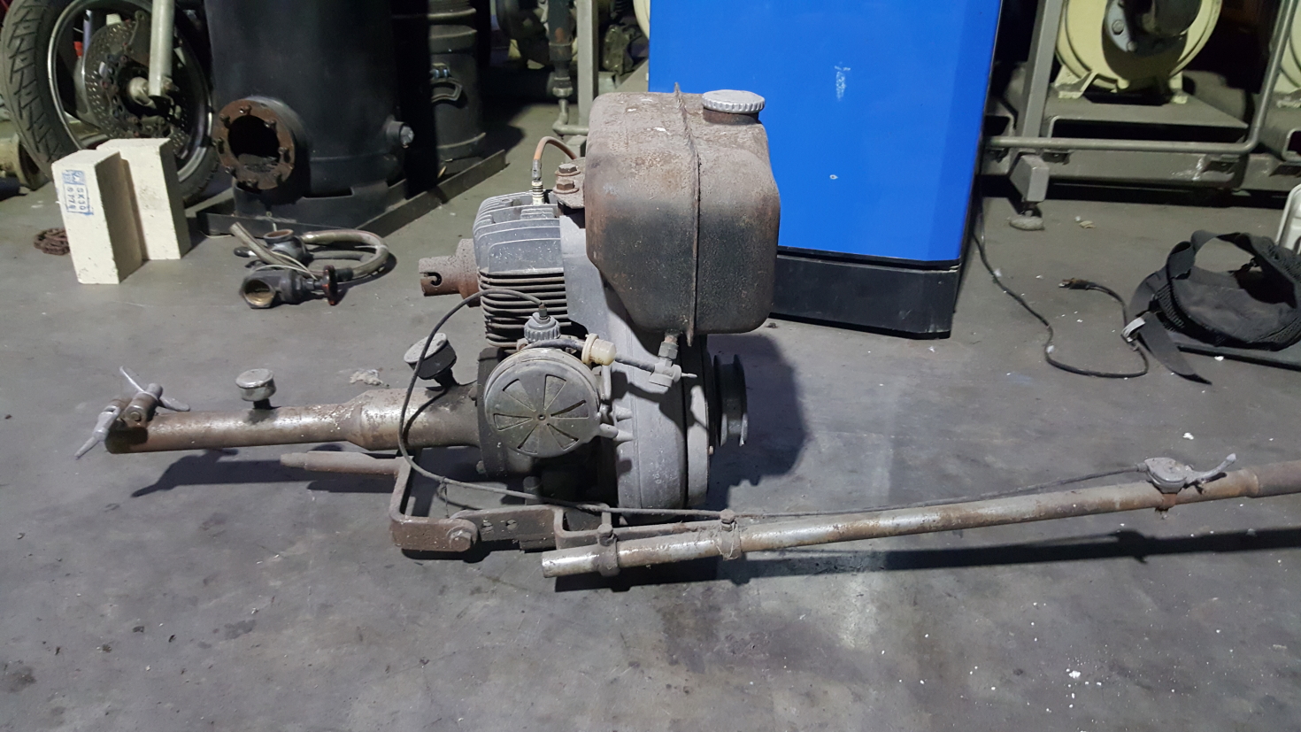

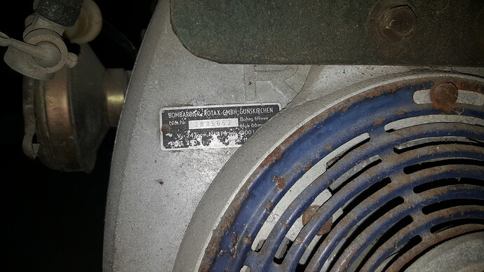

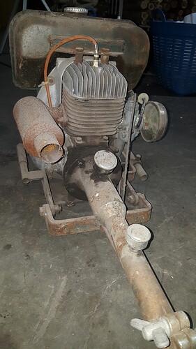

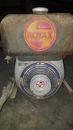

Bombardier Rotax 250cc 2 stroke
The Kawasaki i tried before, never passed the stage of engine overhaul, the new piston / bore was ill aligned so it ended in the scrap.
But now i found this in my scrap pile here…
At least i know the engine is not blocked and still has compression… i needed some thing to wrap my brain around so its on my fun list…
The intended vehicle was a long tail boat… i still have the tail with propeller around somewhere and 2 of these baby’s…
Next is testing on spark and maybe running on a few drops dino before it gets charcoal…

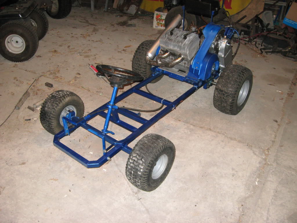

Here’s a pic of a kart I built for my kids years ago. I used a free air 340 Rotax twin, along with the sled’s CVT and reduction box. It was a rocket!
You know the vehicle is fast when 3/4 of the weight is the engine :smile:
