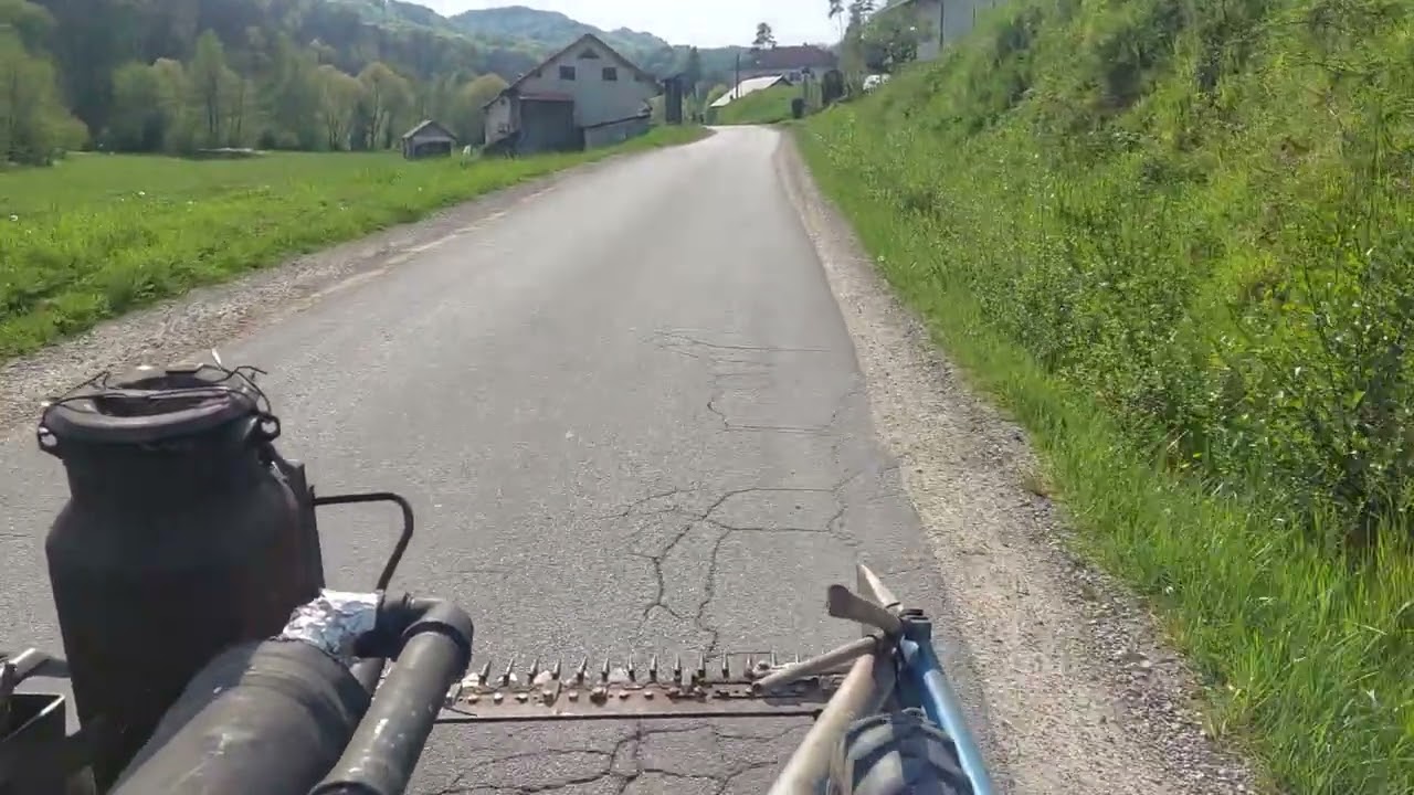

Had to move my char powered BCS home from a friends place today so l thod l make a video to boost your enthusiasm Stu ![]()
I swear l wasnt drunk
its just the damn traveling trolly steers couterintuitive and l only drove it once before. Need to rewire the brain. Almost ended in a trench twice today ![]()

Haha- very MadMax. anything with rear steer is mad at high speeds. especially worn out agricultural stuff I appreciate your humor and your video. And the aircrete- yes not available where I live , but in the city I have found leftovers of a product called ‘Xcallibre’ Its a 100mm thick building block that I used to make my forge from and also a wood fired pizza/bread oven. Its amazing. This stuff- https://youtu.be/Q_DABzqTCkc

It realy is my best ever performing woodgas vehicle. You will see Giorgio, this machine is made for woodgas!
