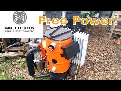

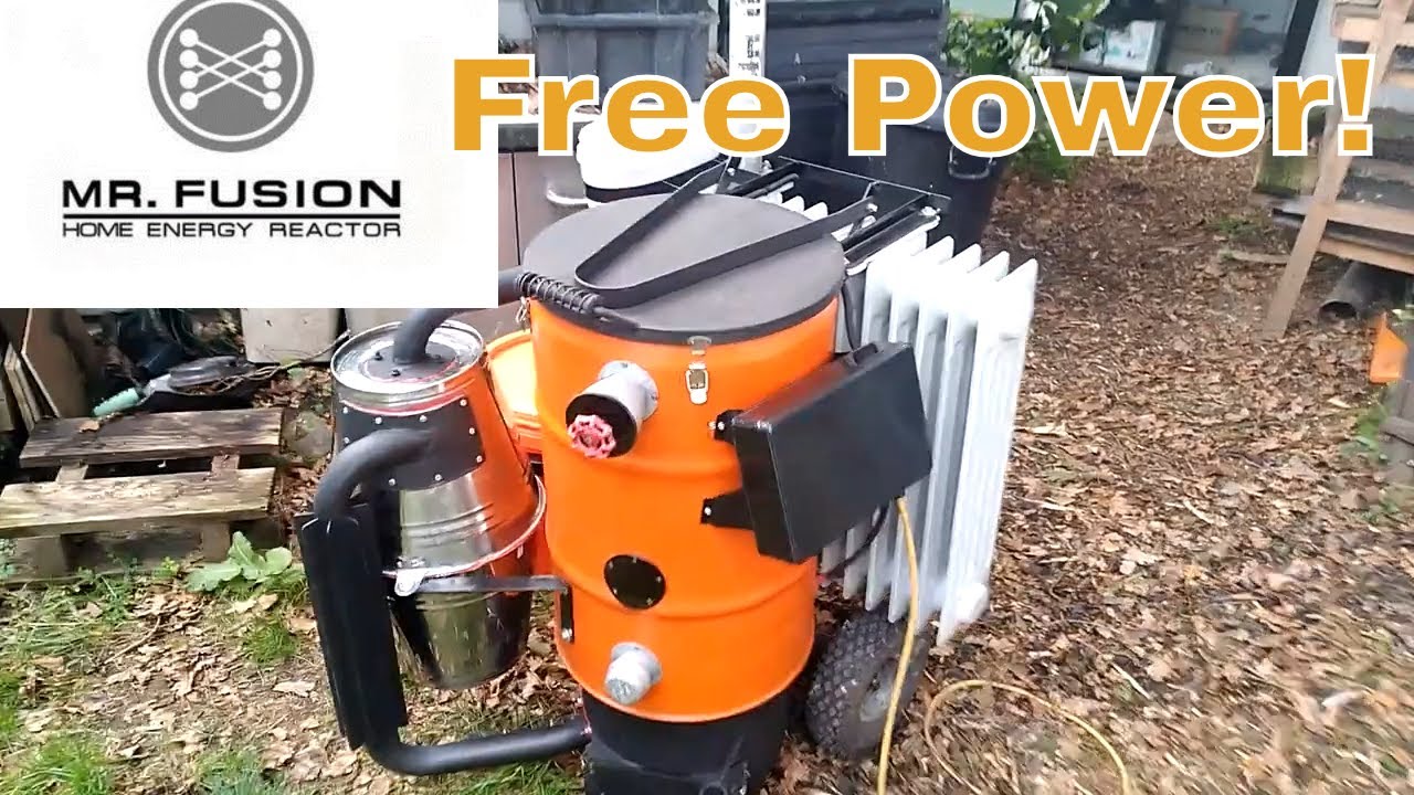

well 4 days of wind and rain has kept me indoors. Yesterday I emptied the feed hopper and discovered
The first issue: bridging. The central nozzle with its 5 separate ceramic outlets is like a big grabby hand that grasps my lumpy charcoal and wont let it fall into the combustion area. Solution- better grading of my fuel stock- Ill make a trommel. It will be so useful for mixing mushroom substrate, garden compost, sieving wood chips. Today Im smacking charcoal lumps on a ply wood board with a shovel like Whack a Mole while I look for free things to make trommel from.
Second issue: Low fan volume. the outlet flare pipe has barely a breath of airflow so Ive removed the pot scourer primary filter shoved up inside the exit from the ash chamber. Also I investigated the wiring and found the second hand on/off switch had extremely high resistance. Rewired to eliminate switch and tripled the air flow. Still not stunning, but after grading my charcoal I expect airflow though the pot to be better as well. Ill be back outside when the weather perks up.

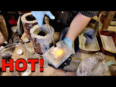

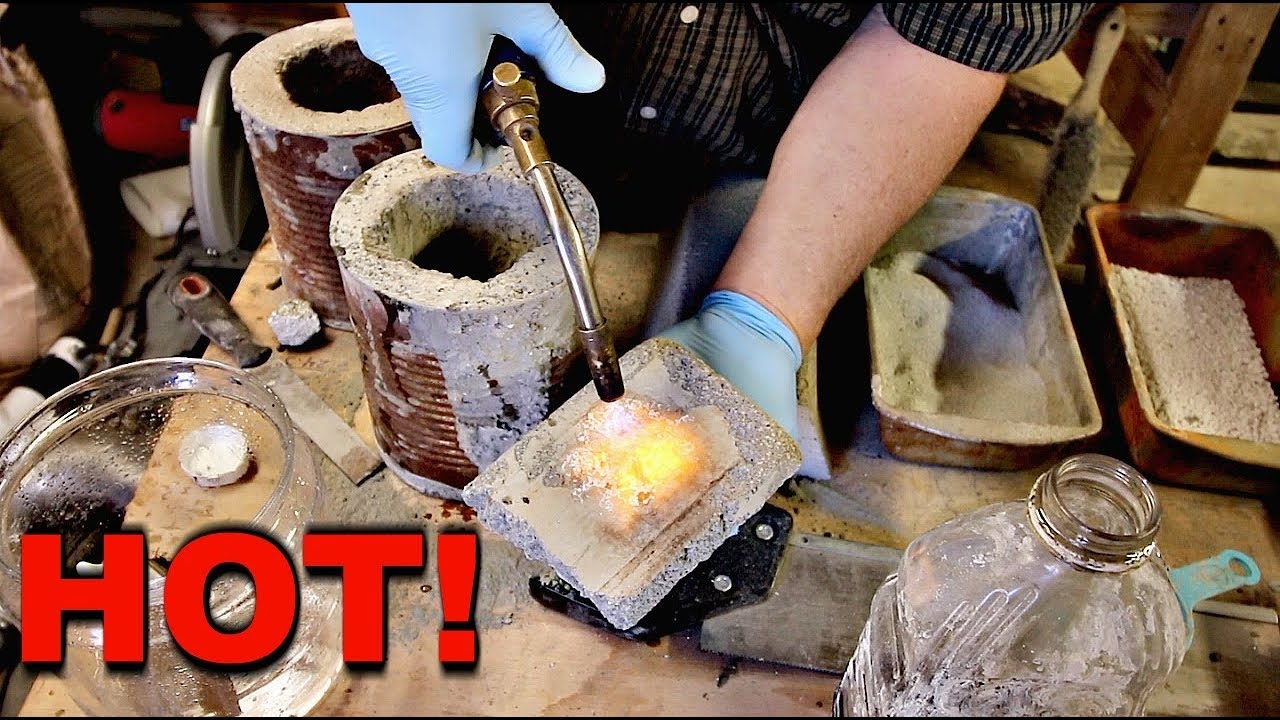

I don’t think it will work for a foundry without an additional refractory coating. The melting point of sodium silicate is 1088 °C (1990 °F). Aircrete will probably work for the portland style foundries because air is an insulator. But you need something with like aluminum oxide for a refractory coating.
that being said, it looked like the original formula for aircrete, during the sintering process they were using an alum which might leave aluminum oxide on the outside of the brick.

Thursday was second light up day.
After attending to bridging in my fuel hopper- poorly graded char. I removed a primary filter- scrunched up steel pot scrubber shoved into my primary gas pick up pipe.
These two actions tripled my airflow and improved combustion. My second light up was much faster coming up to heat, I got a gas flame in 6 minutes. But it was still a very poor color, very orange.
Already- Matt- Thrive Offgrid has watched my video and suggested that I have too much nozzle area resulting in a low velocity of air. That’s an easy fix. Ill make another nozzle with just 3 outlets instead of 5 and Ill give it another burn. I also have an inline 6amp blower on it’s way from Chiinaaa. That should pull the air through more aggressively and I can then fit a variable resistor to control fan speed
Thanks to everyone here who is encouraging and helping me to achieve this. You guys rock!
