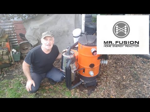

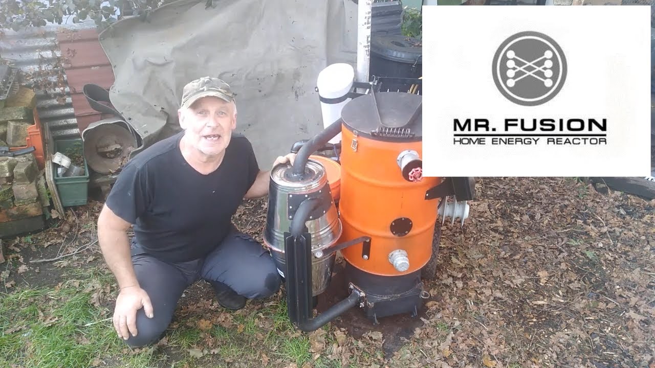

Thanks for showing us a video of your progress.
Alright! Geting there.
The video is probably a montage of both runs yes? Because indeed, the charcoal you loaded in the first time is waaay to corse.
The gas you made will run an engine but if you want it to run real good you got a few more bugs to chase out but you are on an exelent way!
The colour of the gas and flame tells me you still have a bit of problems with conversion. Properly reduced charcoal gas is perfectly clear. The haze in yours and the orange flame are signs of exess water in the gas, that sneaked trugh the glowzone without geting converted to Hydrogen.
You do want some orange, but its different to this. Hard to explain. You will recognize it when you get it
thats the hydrogen. You want to moisten your fuel just enaugh to achive that colour but just before the gas gets hazy.
Try to avoid the grate shaker. Every gasifier must establish what we call a charbed. It must be breathable yet packed enaugh to achive good surface area. It takes time to do so and each time you shake the grate you “reset” the delicate bed. Shaker is a great feature make no mistake, but its only used when over long periods of time, ash starts to form lumps of brittle slag. This takes up volume in the bed and reduces performance. Grate shaker gets rid of these.
100% what Kristijan said , leave the grate to establish its self and once you have the charcoal down to the correct sizes you should not only be flaring off but running a small engine as well .
All the best
sunday evening catch up. - My big inline fan arrived yesterday so I can fit that and redesign the hopper lid attachment to stop a small leak. Im itching for my third burn. but in the mean time I think Im learning Swedish! Im watching some awesome build videos and I think Im starting to figure what they are talking about- But they are nowhere as funny as Göran kindervall
