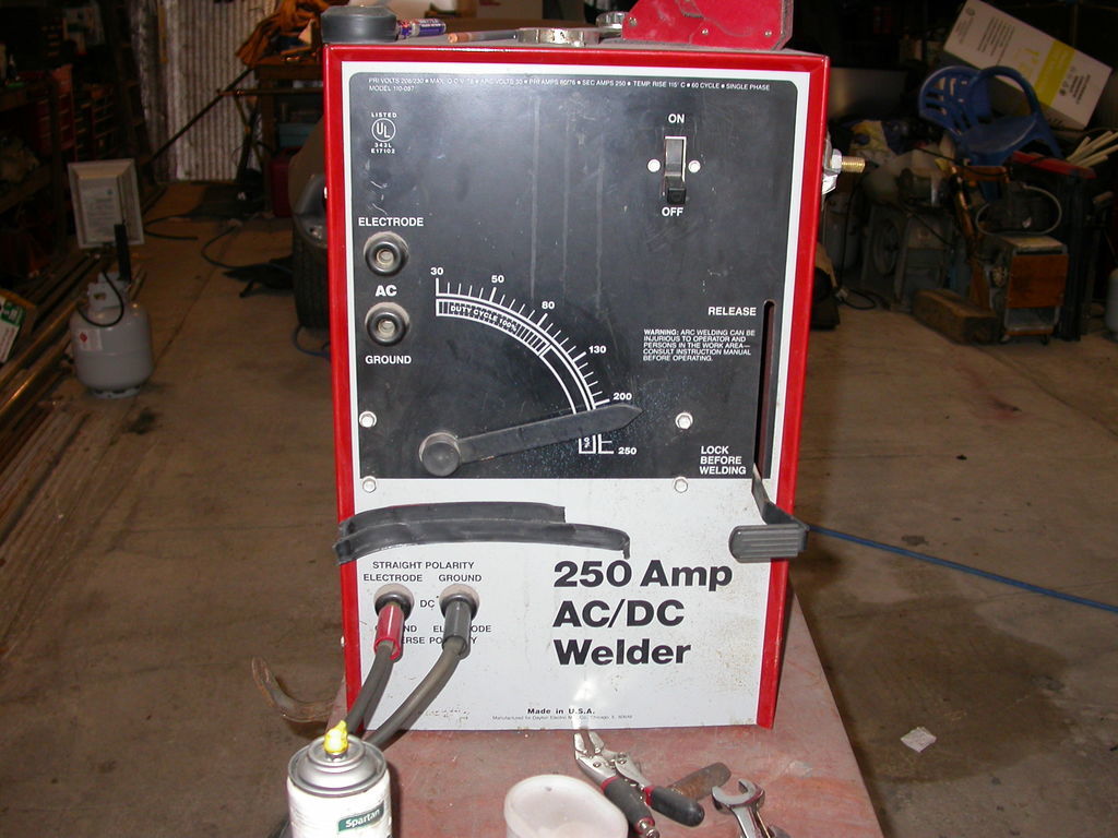

1- Stick welder - Mine is 250 amps AC/DC I will only use DC for Tig because I have no High Freq box.

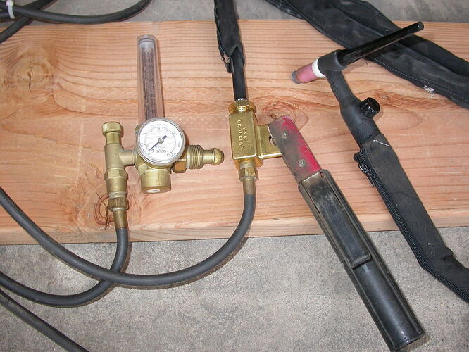

3- TIG torch - one that can handle your available amps and has a manual valve for the gas on the handle. Mine came from ebay for around $100.
4- Power Block adapter - block that you attach your welding clamp too. It is also used to hook up your gas. Gold colored in pic with welding clamp attached.
5- Flow meter - I use the same one from my MIG machine. Switch it when necessary.
You set up the flow meter to the power adapter and Electrode Negative clamp to the adapter. Workpiece clamp to the workpiece.
When ready too weld - turn on gas flow with valve on torch - lightly scratch tig tungsten to metal to start arc. Like striking a match.
Weld away! Remember to shut off gas flow when you have finished running your bead.
