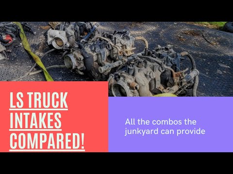

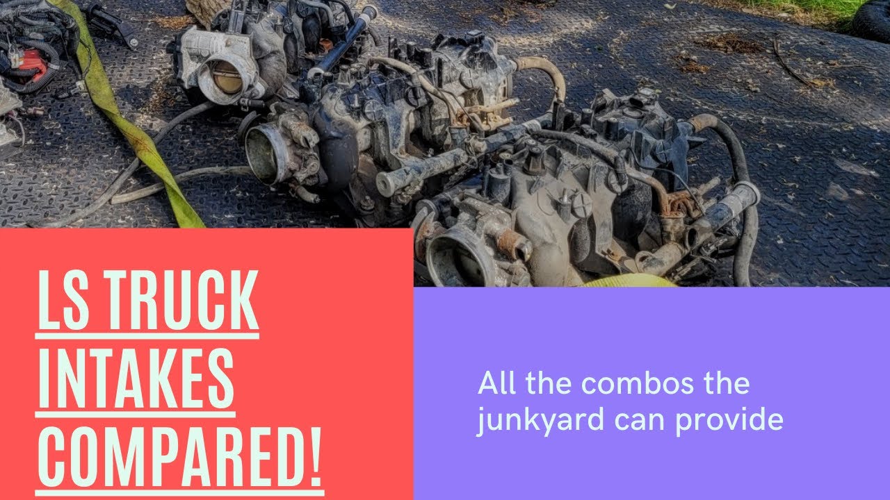

This is what he has:
Very long paths with flow reversals internally.
Even most four cylinder engines sinch the early 2000’s have plastic intakes with dual pathways and then flow shaping “tumble flow” convoluted internals.
All of these are cast and molded as one piece. No disassembly possible unlike the earlier gneration cast aluminum factory intakes.
The good news on your year of GM V-8 is as Marcus said availble metal welded up intakes available.
The good news is there are buyable PCM modifier overlay kits.
Better news is if you follow this Driveway Engineer fellow’s GM LS topics info there are actual re-programmers (humans) who will reprogram the factory PCM’s.
