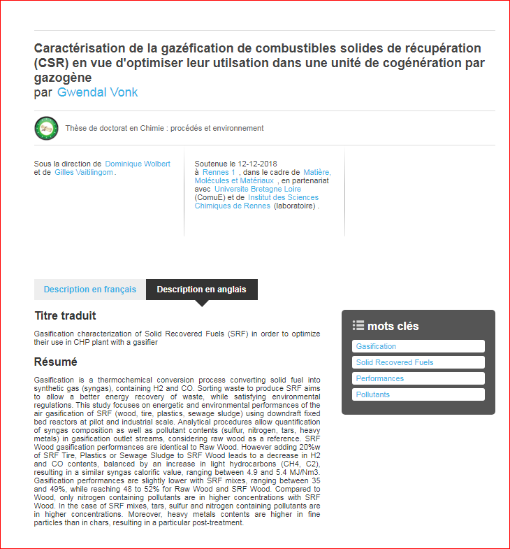

While can’t say where because I really don’t know, I’m pretty sure large scale waste gasification existes
