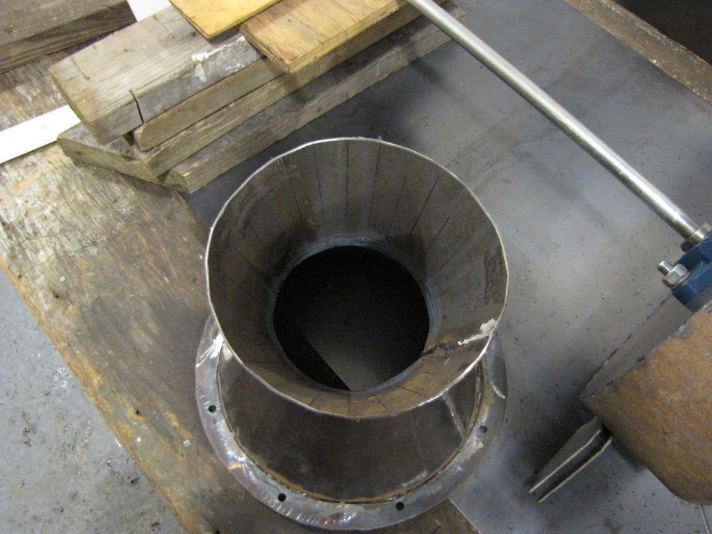

Thanks for the link “Pepe”. . . I especially liked the sections where it shows hows to make transition piping from round to rectangle, inlets to cyclones, blast gates and manometers. Lots of good information in there that will allow me to make good use of my new 36" Harbor Freight brake!

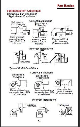

Hi Everyone,
I just found this little nugget for fine tuning your gas stream flow. Now
I’ll have a better picture of my footprint

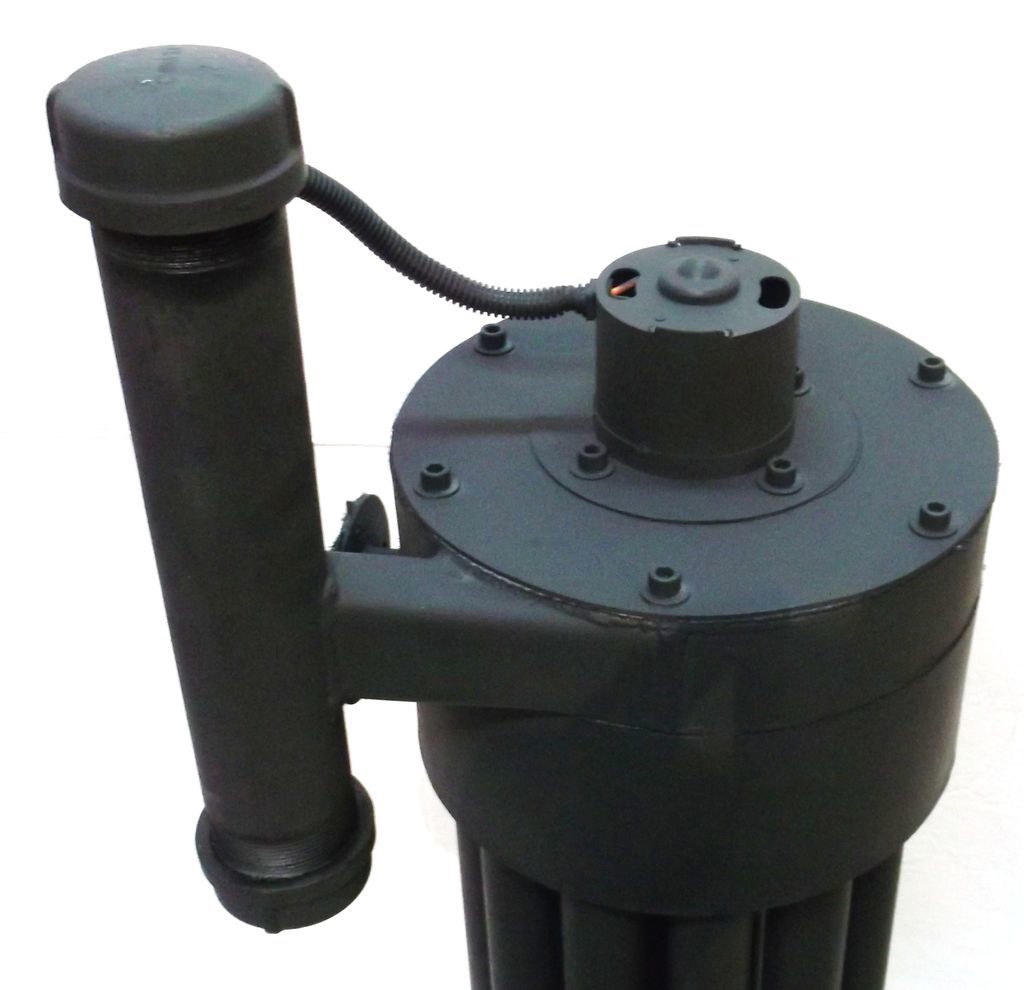

Yup that is why I integrated my blower directly on top of my condenser. The flow comes direct from the cooling tubes into the blower housing with no choking or restricting. Ive developed a new blower that is unbelievable, It has ten times the power that my old versions had. The old ones did the trick lighting but I still wanted something with a little more power. I found these leaf blower impellers that are a direct fit to most automotive heater blower motors output shafts. You do have to grind the flat on the shaft a little to match the flat in the arbor of the impeller. The housing is simple to build too.

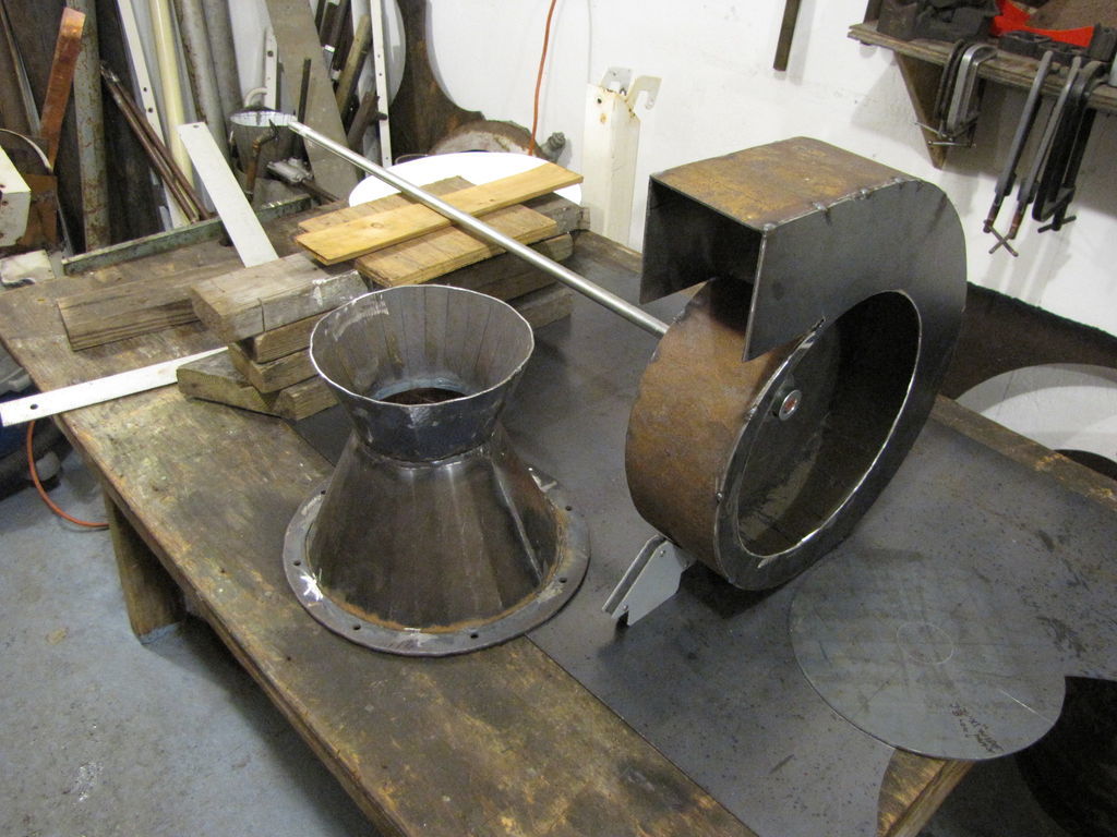

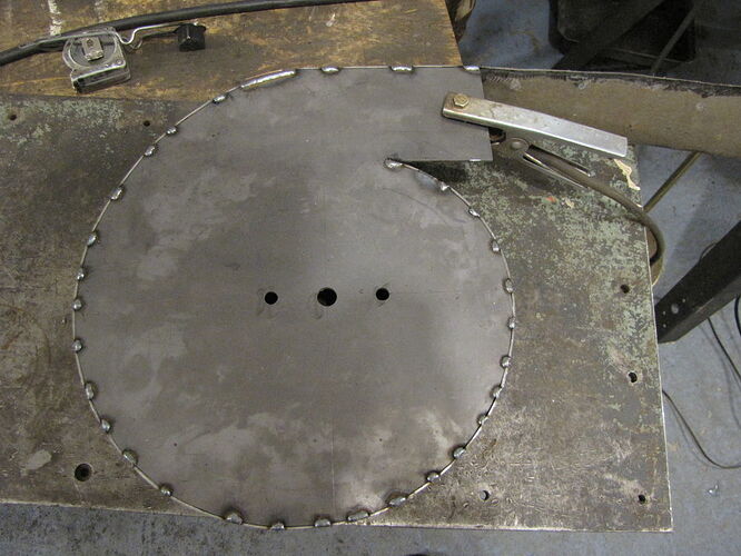

Hello Fellow Gasifiers,

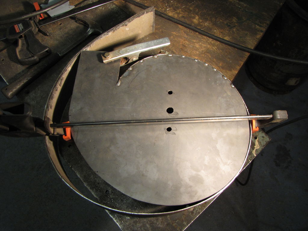

I finally made some time to get going on a new 10" fan modeled after the one in the David Gingery Book,
“How to design and build centrifugal fans”. Link is in first comment above.

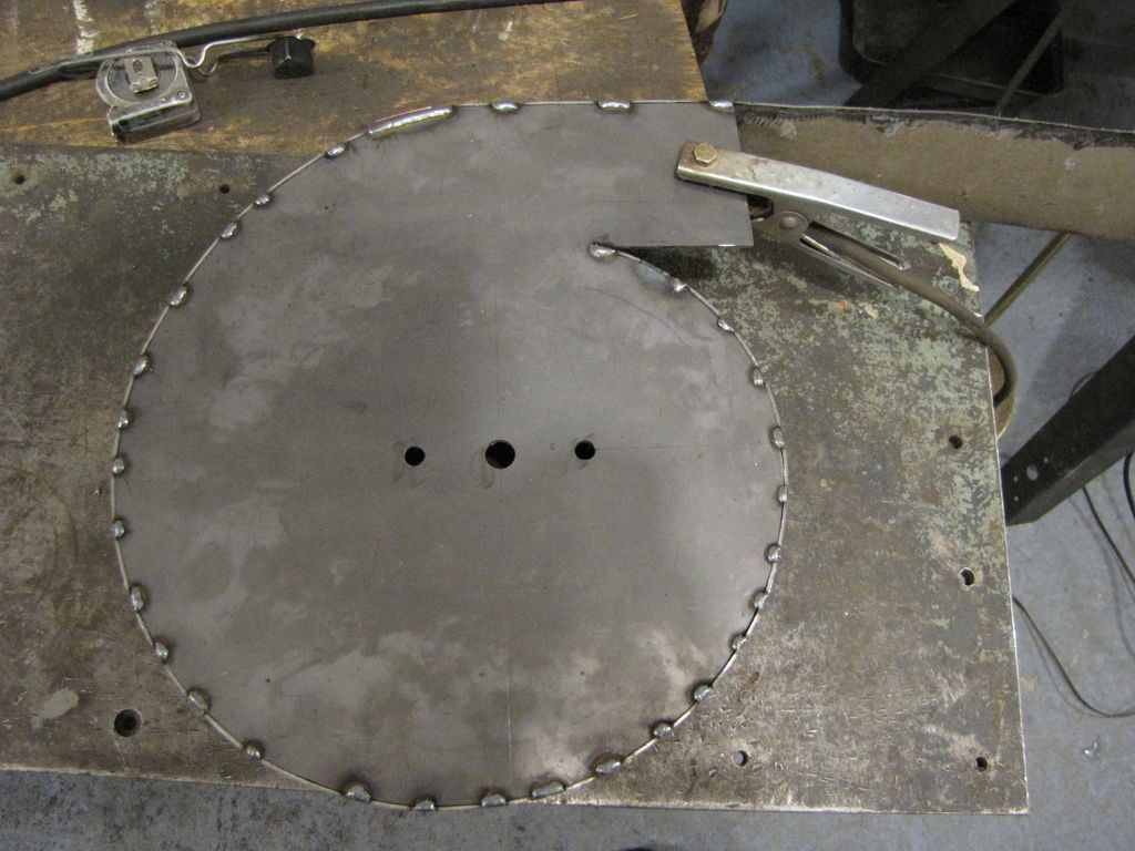

Pic 1 Full size drawing of back plate. Also described are the rotor removal hole and the removal hole cover plate. An inlet will be in this cover plate centered on the rotor shaft.
Pic 2 Set up an X and Y axes on the 1/8" plate steel to coincide with the axes on the full size drawing.
Cut out and tape down the full size drawing lining up the axes and trace it on the metal. I cut mine out with a De Walt sabre saw with a “heavy metal” blade. It was a little slow but an extremely accurate cut. Now one more for the other side.

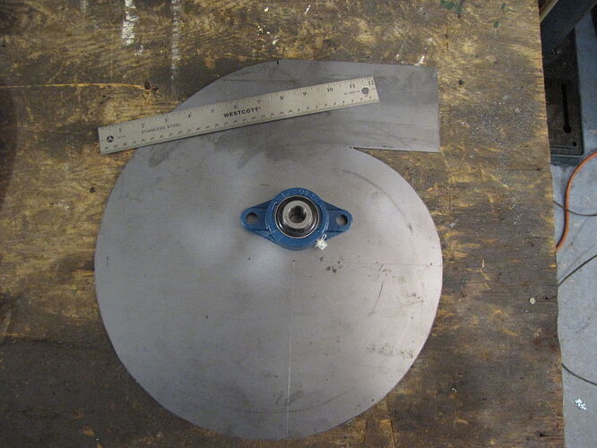

Pic 3 Now layout the center hole and the flange bearing mounting holes carefully. Center punch the holes and drill an 1/8" hole at the three locations. Drill progressively larger holes up to the desired diam.
Pic 4 Invest in a good ruler with 1/32" intervals for accurate layout.

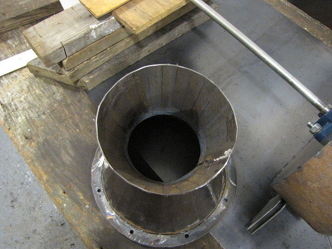

Pic 5 I cut a 4" ring off an 80 gal H2O heater and put it through a roller to shape the circle here. Much
easier to handle curved. Leave your axes on the outside and fit the 4" piece at the junction point E. Carefully square the side with the base and tack weld a couple places. If you start good and square here the bottom edge should wrap around and stay square at all points with the rotor Note the backing plate is inside the 4" piece.all the way around.

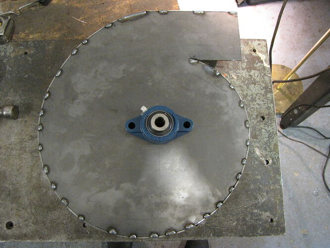

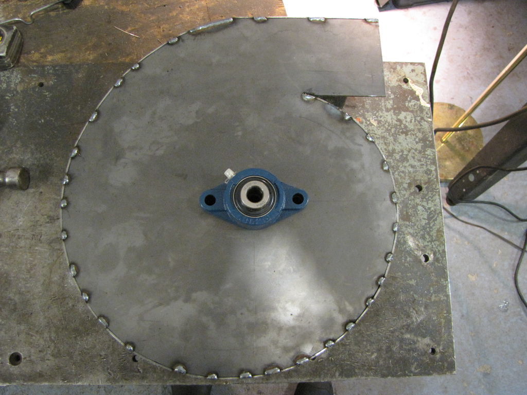

Pic 6 Using clamps for good line up work your way slowly around the edge tack welding as you go.
Pic 7 Backing plate tack welded in place. Note the center hole and the flange mounting holes have been drilled. Constructions lines are evident.
Pic 8 The flange type ball bearing shaft mount in place. You may have to enlarge the center hole a bit so the shaft doesn’t rub on it. This sealed unit will have a gasket.

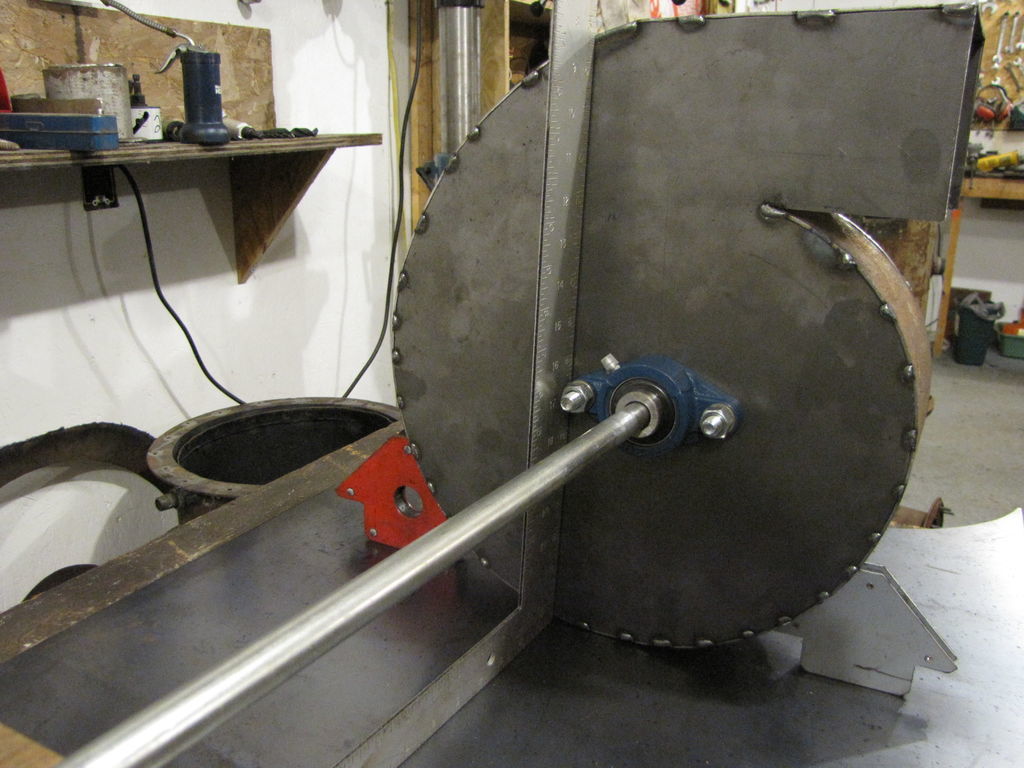

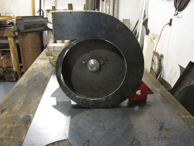

Hey Guys,
I finally made some progress on my fan and my new hearth.
Pic 1. Cut out and installed face plate with rotor removal hole.
The cover for the hole will house the inlet.
Pic 2. Dry fitting the rotor shaft in the flange bearing. The heads
on the bolts have been ground to 1/8" thick and will be
welded on. The small pulley will be welded to the rotor as
a connection hub for the rotor shaft. There will be 3/8" space
between back of rotor and fan wall. Gingery says this isn’t excessive.
Cover plate to top of vane will also be 3/8". Now I know the vane
height. What I call high is referred to as wide in his book.
Pic 3. Simulates the position of the drive shaft when installed in the
pillow block bearing.
Pic 4. Micro(lol) shimmed to parallel to the table and face plate square
to the table. Final design for motor mount depends on how I
decide to integrate the fan into the system. For sure it will be suction.
Pic 5. My new hearth, 2 new cones, to meet line D of Imbert dimensions
with a 4 3/4" dr1 (restriction) and C/L nozzle to restriction distance h= 4 1/4".

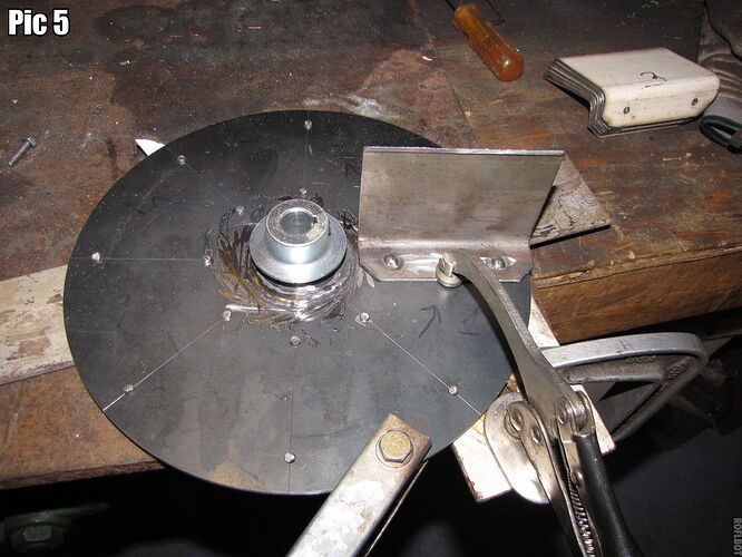

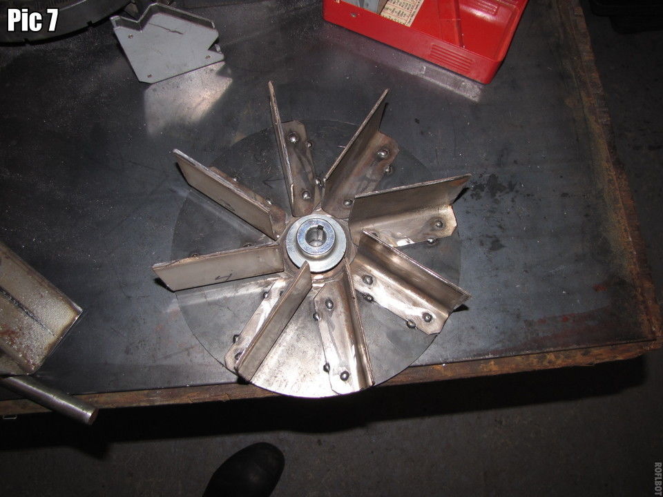

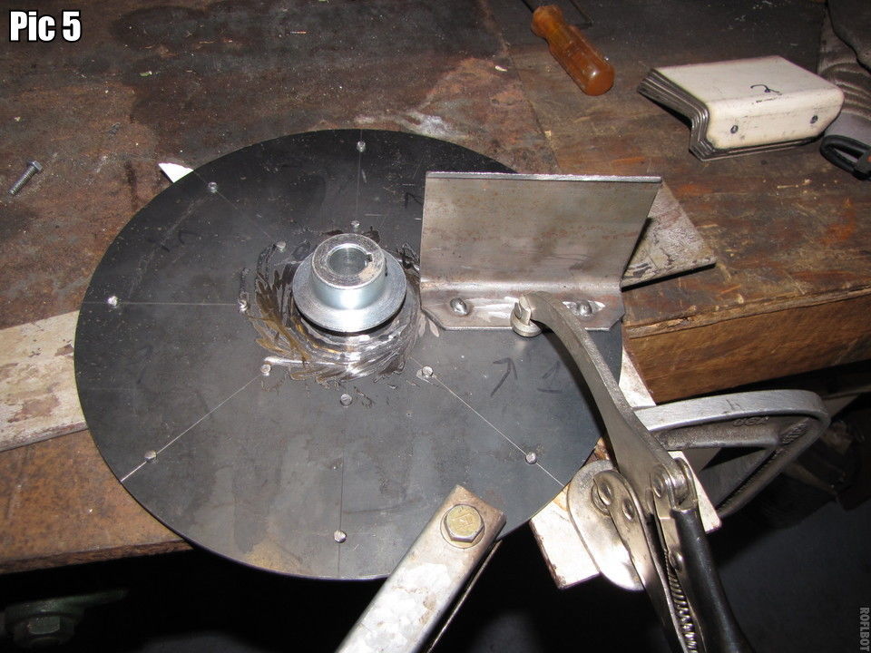

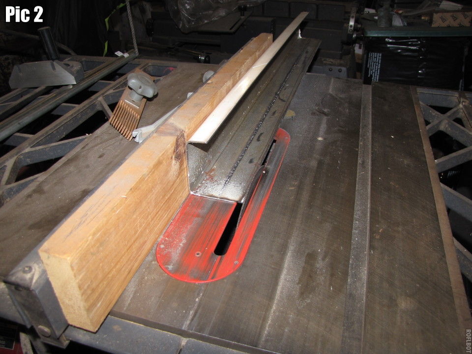

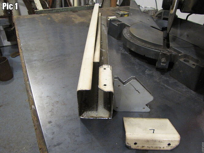

Hi Everyone,

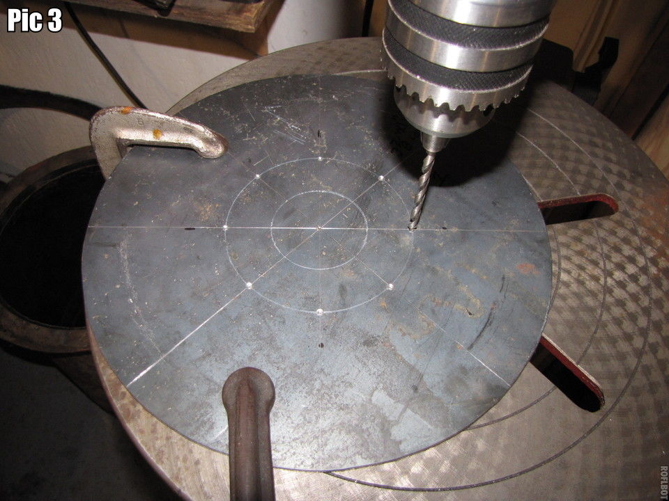

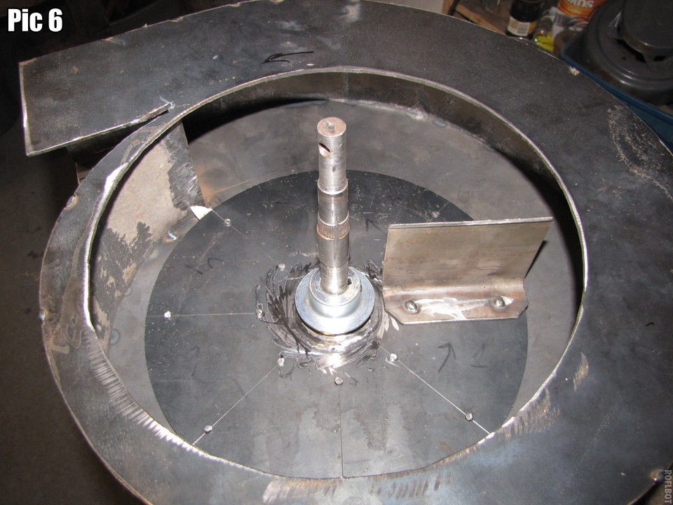

I spent 3 or so hrs on my fan rotor in the last few days and finally have it almost finished. I have to calculate the inlet hole diam before I can cut the angle on the inside of the vanes. That cut begins where the inlet diameter intersects the top of the vane. The cut then tapers down to the top of the pulley (not the top of the hub). Beyond that point fan performance and efficiency decline. I have several changes in procedure that I will note in the respective pictures.
Pic 1 Ripped a 3" sq. tube (salvaged from an old treadmill) to end up with a 1" x 3" x 32" angle iron.
Set up a stop block at 3 7/8" and cut the 8 vanes to length on my chop saw.
Pic 2 First time using my table saw with a metal blade to rip the angle iron out. Works great, just let
the blade do the cutting slowly. Oh yeah, vacuum out all the sawdust first so you won’t wonder
where the smoke is coming from, lol.
Pic 3 Layout the x and y axes and the 45 degree lines in between them very carefully. Layout the pulley
diameter for reference. Measure 3 1/8" from the circumference in on one line (3 7/8" - 3/4")-
both mounting holes are 3/4" from end of vane. Scribe a circle using that point as the radius.Then
center punch each of the 8 points and drill the mounting holes. See Gingery’s book for more details.

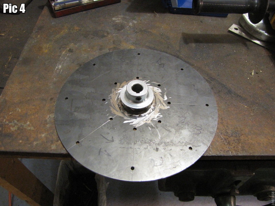

Pic 4 Use the 5/8" shaft to center the pulley and weld in place. Gingery had a hub that bolted in place.
Pic 5 Mark and drill second vane holes. I used 3/16" rivets through the rotor and vane. I cut them flush
and spot welded them. I put a couple of spot welds on the vane also. Next time I will just weld it all
slowly so as not to warp the rotor.
Pic 6 Test fit.
Pic 7 Almost done and a whoops moment. I forgot to cut the vane angle. Now I’ll have to make a mess
with the torch-chabunnagongamog! The angle starts on top of the vane at the edge of the inlet hole
and tapers down to the top of the pulley (not the top of its hub).

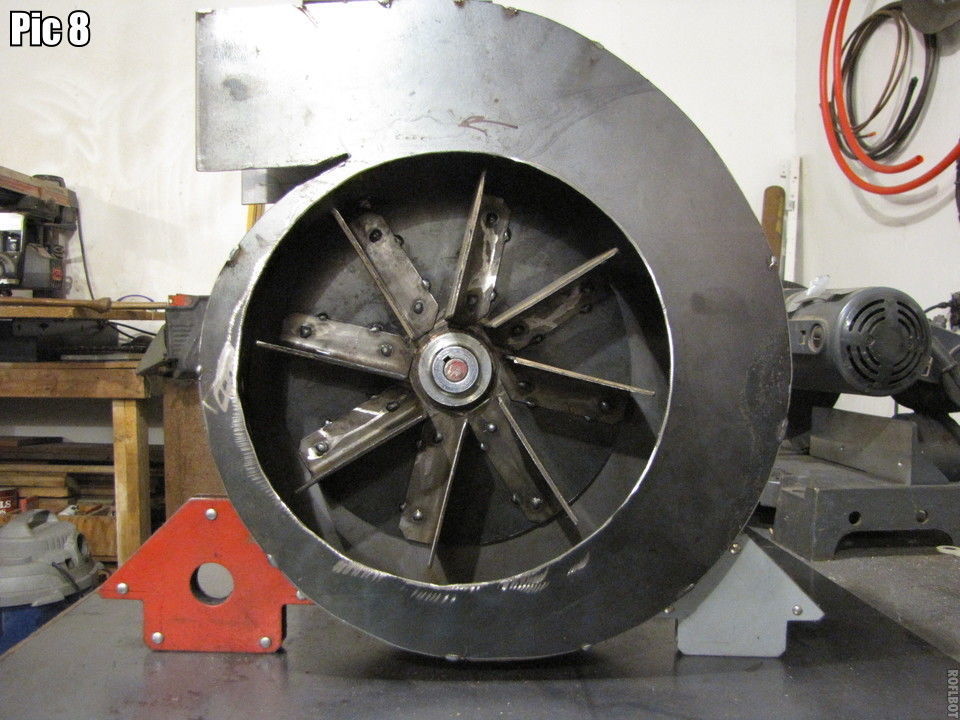

Pic 8 Test fit for a feel good moment and another whoops moment. I neglected to include the thickness of
the rivet head underneath in my clearance calculations, so I’ll have to grind down the heads on the
flange mounting bolt heads another 3/32" for better clearance. Don’t want any clangs like my last
fan fail!
UPDATE: Clamp 2 consecutive vanes to rotor before you weld on hub to insure you can easily insert the hex key for tightening.

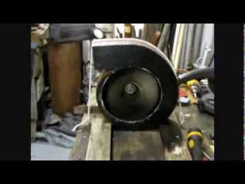

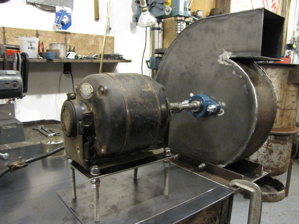

Hey Guys,
I finished the rotor and jury rigged a connection to my motor for a trial run.
The fan ran pretty good and it puts out some serious velocity and volume. I definitely need some speed control for my smallish gasifier. I guess I can incorporate into the bigger picture now.
Had to post a short clip at

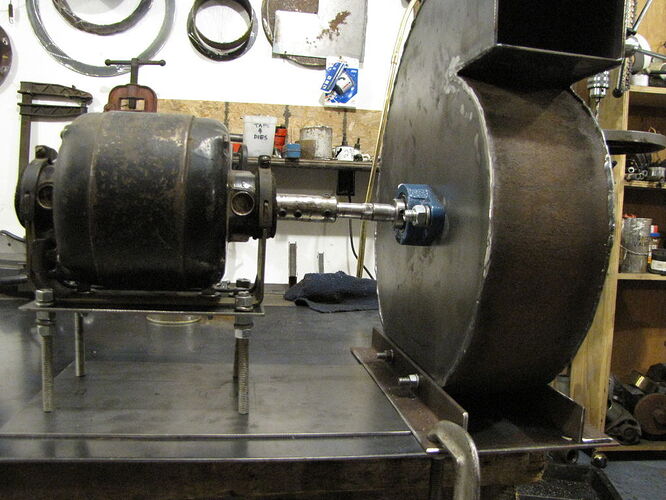

Hi All,
Spent a couple of hours on the motor mount assembly today. The motor mount assembly will bolt to the base of the fan and floor/base of where ever it’s installed. The motor bracket is bolted to a height adjustable platform. The platform’s posts will be bracketed with a 1" high fence welded to the base on the inside of the posts to provide lateral stability. The motor bracket itself has a (from C/L) 1/4" + or - sideways adjustment which is great for good alignment and smoother, quieter running. Should be able to test run it tomorrow. Pepe
Then I’ll set up and pressure test it and report. Always wanted to do the manometer thing.
