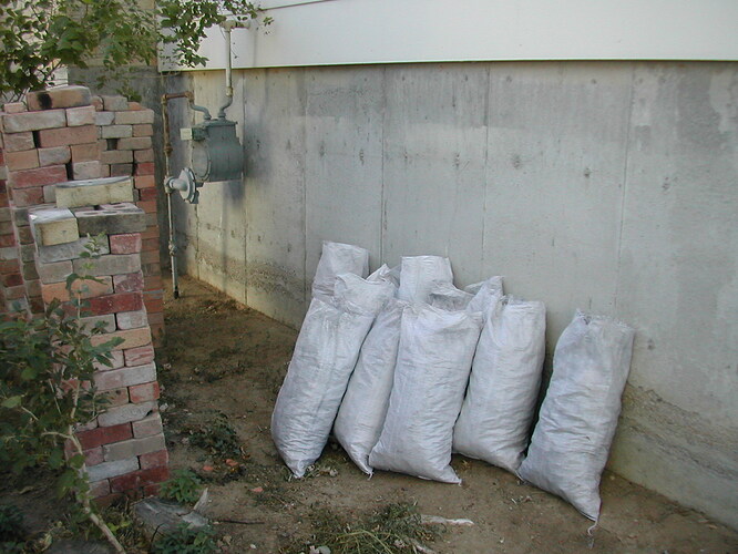

It sounds like you have got it going now where you can make good quality charcoal in bulk batches. How are you storing it now for later use Carl?
I just store it in sand bags.

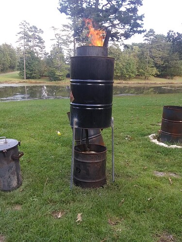

Here’s my new bottom lit charcoal producer. It’s a facsimile of @Matt system. Need to make the grate a little bit tighter so I can use branches as well as boards. Using pretty long pieces just to try it out but I shouldn’t be using pieces longer than 18" or so.
