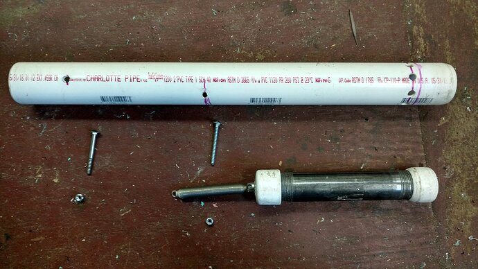

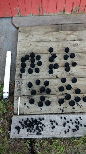

Thanks guys for the input. Things did not go as expected today. the new briquette maker fell together nicely, but the one-two three fantasy was a pipe dream
. I needed to hammer several times to get a tight briquette. So much for 1000 briquettes per hour. More like a hundred or so per hour. I did several samples to compare density based on number of hits. Also, this batch was also done with more coarsely screened charcoal. It is supposed to be sunny for a couple of days so i should get some results soon.

Lighter pipe is good for the arms. Small warning though, in my experience with such devices, you need to protect the contact surface more than you think. We tried lighter stuff cutting plugs and a couple other similar applications. Found out that you will inevitably hit off-level and bend the edge, or hit a rock or something, and the end of the pipe will not long be round. PVC might be better than metal for that. Also, after not-so-long-use metal pipe will begin to mushroom unless the contact point is pretty heavy.

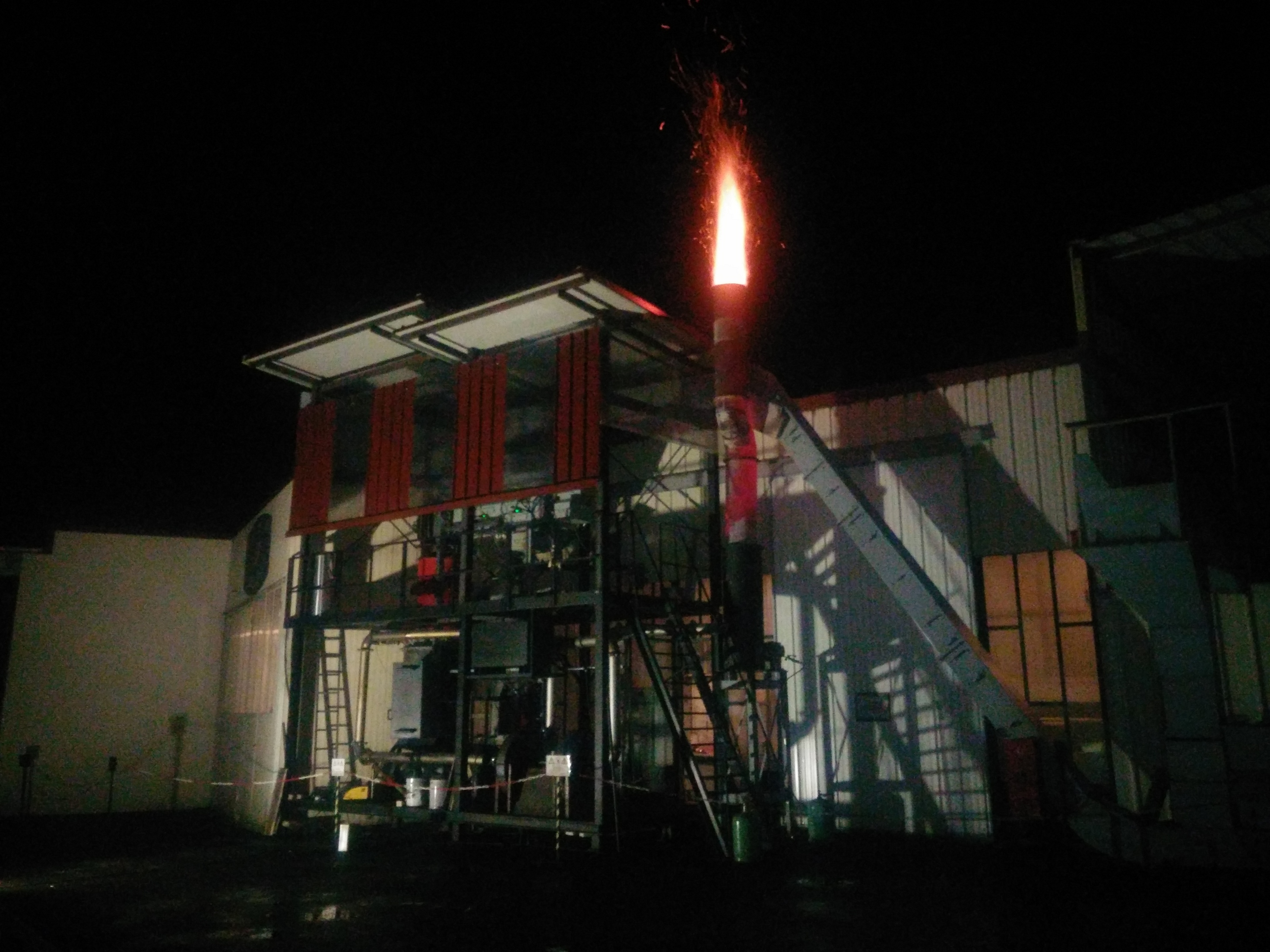

I have a professional trip atipique, which for me at first did not make sense, but now that I know the military history of my grandfather, everything became clear, I started carpenter, then at 28 years I I became a public works land surveyor, then a public works contractor, I created a public works company in tarring. I built a turret machine on a forklift (https://youtu.be/NXGeXZMV50w) to make small areas, then I had health problems and I had to sell my business, so after my recovery, I looked at energy, and understood that for the planet, the wood gasifier was a solution for have renewable energy.
the French state paid me two years to do research in this area,
this is since 2011 that I build gasogens.

which explains my professional career, carpenter for gasifier formwork, geometer for drawing and presicion, entrepreneur for the management, now everything has a meaning to my life, I managed to convince my company where I realize prototypes to build container gasifiers for africa are equipping the villages, so the unqualified little hands are looking for dead wood in the forest, giving them a small income and in the evening the group gives electricity to the little schoolboy to do their duty.

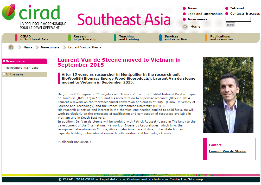

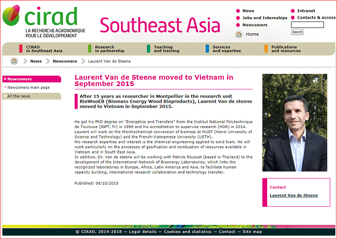

Koen, one of my acquaintances is not far from you, you can contact him for your work, one of the best French in the gasification,
doc below.
Cordially.
600KW / h thermie, it will be good for your drying device in your factory, a very great regularity in volume and quality of syngas.

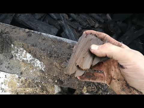

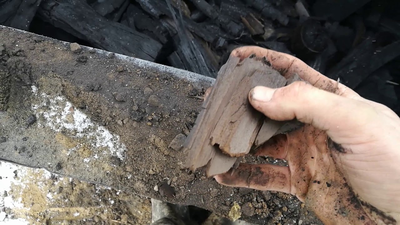

My co-worker has a side business as a barbeque chef. He is real particular about controlling flavor with his marinades and sauces. So instead of using tarry commercial wood charcoal , he prefers my high temp retort charcoal.

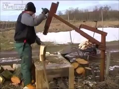

How about something like the below video? Replace the wedge with a tube. Limit the travel. Pellets exit the top of the tube. Movable charcoal troth below tube.

Thanks, Jeff. I am still looking for the best way to make engine fuel from crop waste. Currently it is a toss-up between making mini-briquettes and pyrolyzing cassava stems. Iâll give this spring balanced hammer method some thought. If I follow your thinking, I could also just keep hammering my tiny briquette tube by hand until the charcoal comes out the top then knock off pieces as they come out the top.
BTW, I built one of those log splitters. They work, but much I prefer a splitting axe.
Maybe cone shape or a choke might help compress or just longer. Should break off by itâs self. Nice project, wish I could be there to help ! ! !
I carbonized switch grass and rolled the dust into fireballs inside a cement mixer with the stirrers removes. Your way is easier.
