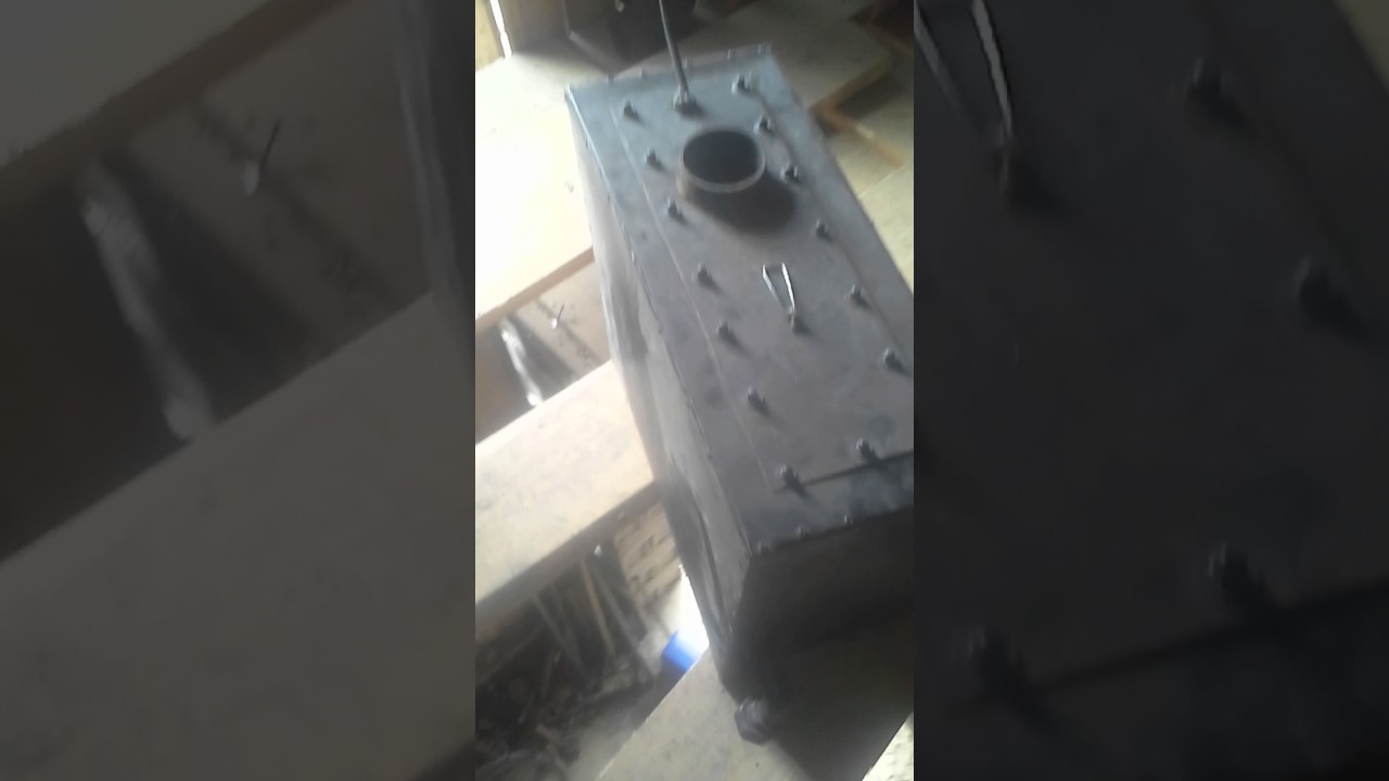

Hi Andy,
Took the old gasifier out from the dusti shed attic, hope it helps.
The metal is intact, rusted from the moisture, but ok. Just awirebrush to clean the ash and rust and its good to go. On top you can see the gas exit mesh.
l got nostalgic looking at it… Man l love black gold!

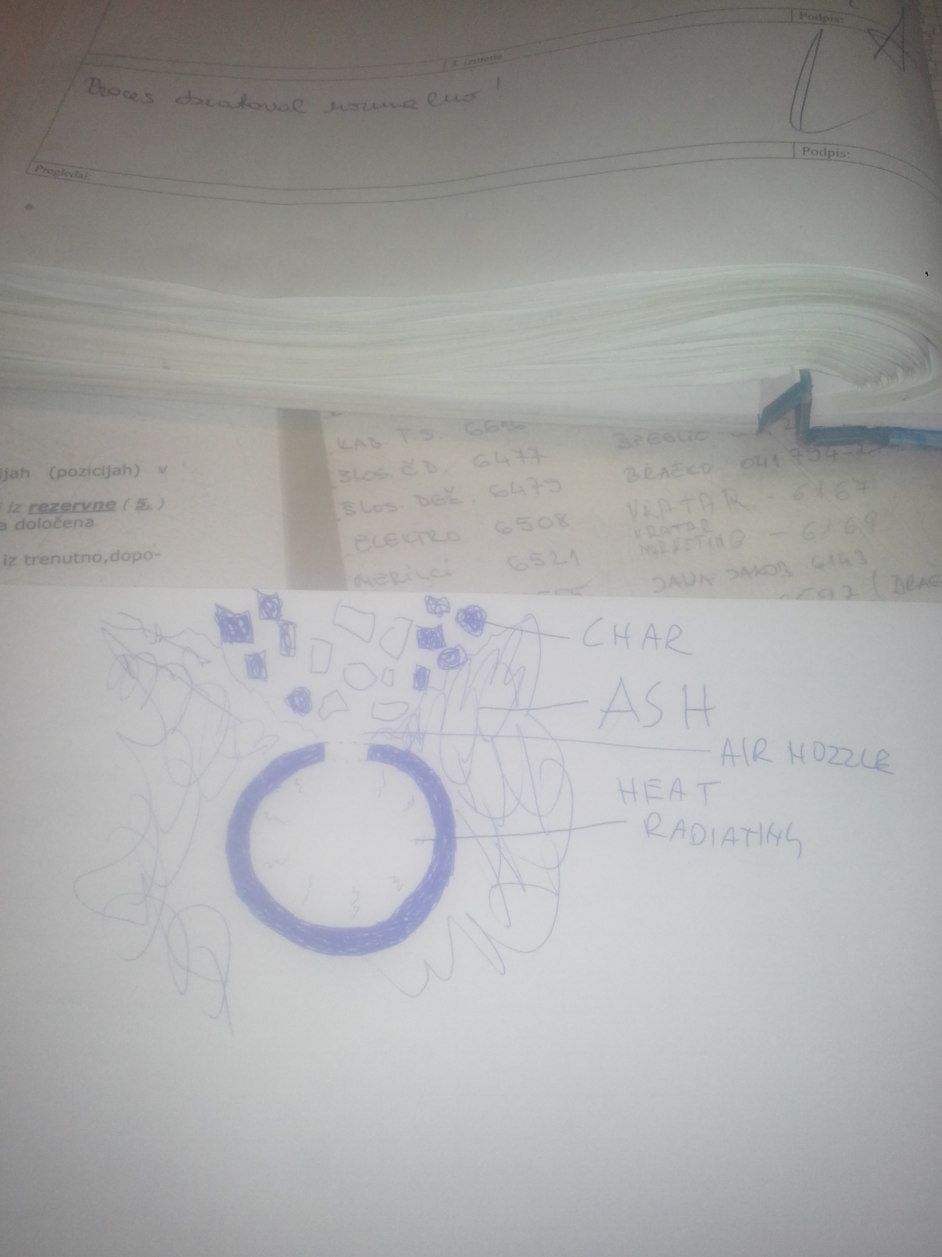

Hi Kevin
Not sure of what you mean with radiator nozzle, the nozzle on this sistem and everyone of my later gasofiers was a horisontal thick walled pipe with holes on top. I have the same arrangement in my Mercedes now, about 2000miles driven with no decay to the nozzle.
Hi kristijan i thought the nozel was double wall with a water jacket that went too the radiator. Or what was the little radiator cooling in the pick’ sorry i dont know how too find what post or page it was on. Are you cooling the thick wall pipe with slots with a water jacket or ceramic too cut back on oxidization.And are you useing some sort of grate too rid the excess ash from around the nozel.Thanks for posting your build designs. I just got the picture of how Dons Manns gasifier works,his has the pully rotator that i think the char slips between too fall intoo his ammo can? And his air pipe just enters down in the ammo can below the pully air nozel was my interpitation of his unit.? And when i looked at the simle fire at gary gilmore vidios, i seen no grate too keep ash from pile’ing on top or around his nozel pipe.?coments on those subjects please.Thanks
Hi Kevin!
Nope. Just a thick walled pipe with holes drilled on top. No need for any other gadget.
I wanted to make a video for you today, to show the nozzle from the inside of my Mercedes gasifier, but didnt have the time.
I used no EGR in my Seat gasifier and the ash formed a volcano on each hole in the nozzle pipe, out of molten ash. I use exhaust to cool the reaction now on the MB, wich prevents. Instead, the ash forms a thin lair on the pipes surface and protects it from direct heat. All the heat that gets by radiates in the big pipe to preheat the air.
